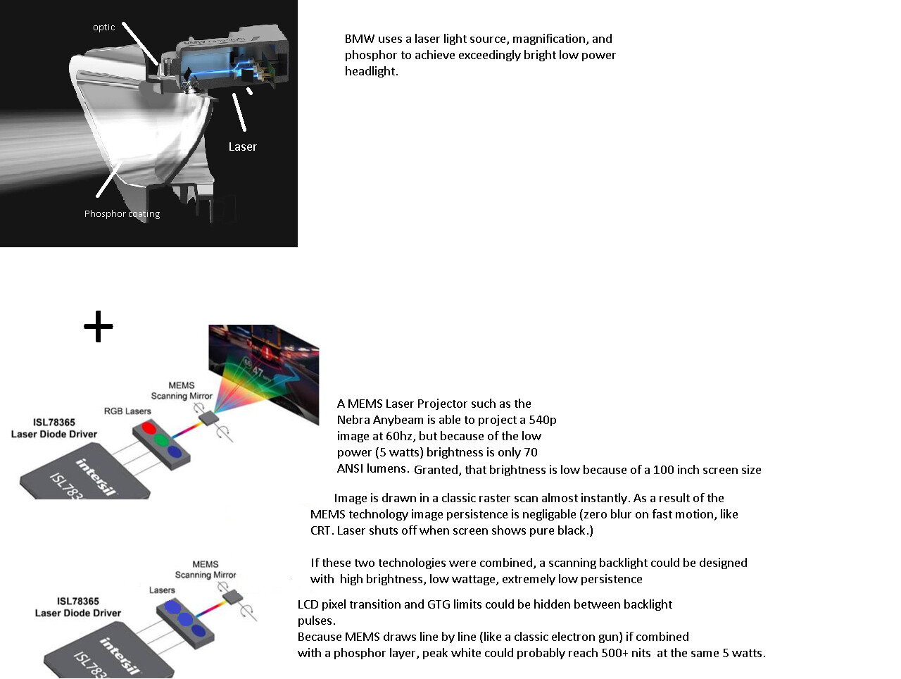

Here is what I wrote since I haven’t heard back lol
@nordic @PimaxVR @Alex.liu
Hey Martin, this isn’t for Pimax Experience exactly, but for the engineers over there. Please show my idea to them.
Here is a picture I made to vaguely illustrate the concept
I had an idea to make the LCD back light in the Pimax way better than any LCD back light bar none. It would allow your LCD to do near infinite contrast just like OLED, (because the laser would scan from top to bottom like a CRT,) would eliminate LCD motion blur and pixel transition artifacts hiding them during scannout blank periods, and would achieve peak brightness at 5 watts of power that would be 30%+ brighter than any LED that would be driven at much higher wattage and heat output.
Imagine a strobing back light capable of drawing a single line that has a brightness of 500+ nits at under 10 watts, and drawn almost instantly. Imagine a back light able to shut off wherever black is on screen without the need for dimming zones or complex programming of algorithms.
Combining a MEMS laser scanning system (like what is found in the Nebra anybeam or ShowWX projector) with a phosphor layer as found in BMW laser headlights, you would create the perfect back light.
If you watch the video below, you can see how this laser projector draws an image. It draws line by line just like a CRT does. (you can see the white line moving down the screen) When the screen is black, the lasers merely shut off.
Instead of drawing an entire image as the projector does, the mems scanner would be programmed to draw a single line of light that goes from top to bottom like a raster. The low watt laser strikes a phospor layer that emits insanely bright light.
