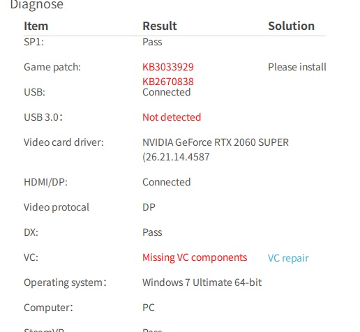

Pimax diagnose told me that i need to install VC repair. How can i install it, if i cant download it?
Somebody have this file?
http://pisetup.pimaxvr.com/vc.zip

PiTool diagnose cant see KB3033929 and KB2670838 that i have actually installed, and it cant see usb 3.0. How to make it works?

Ive got both KB installed by DISM, because automatic install not worked.And Visual C++ says its the nevest.

You may need a different vis c install. Did you try clicking on vc repair in pitool diagnosed?

I dont know from where i can download other versions of pitool. All sites are dead. Clicking in vc repair ending on dead site as i said.
I wrote to support and now i have file from them. I’ll try to install it now.

After i installed VC from support, diagnose said it pass. But still steam says the headset is in standby mode and i need to move them.

USB 3.0 still says its not detected. Both KB patch same, not detected.
