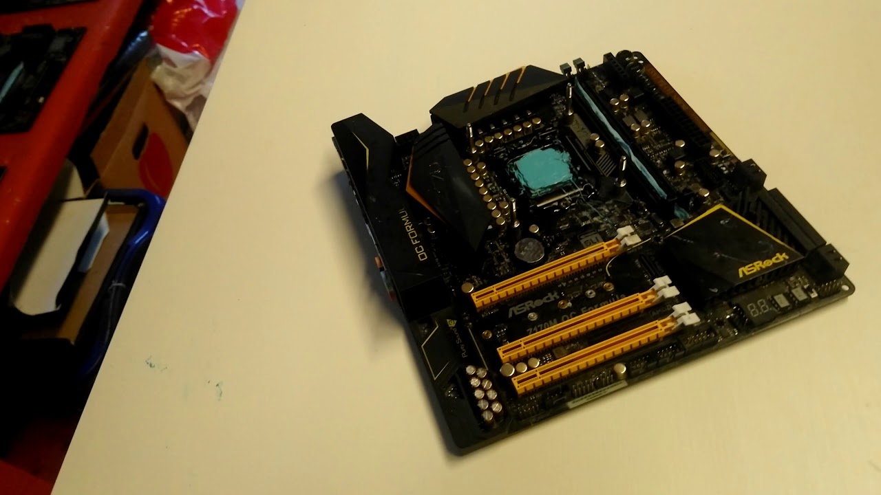

Here is one of the vids i found just by searching coffeelake z170 on youtube:
unfortunately there is no list of mobos. You have to search for yourself…
