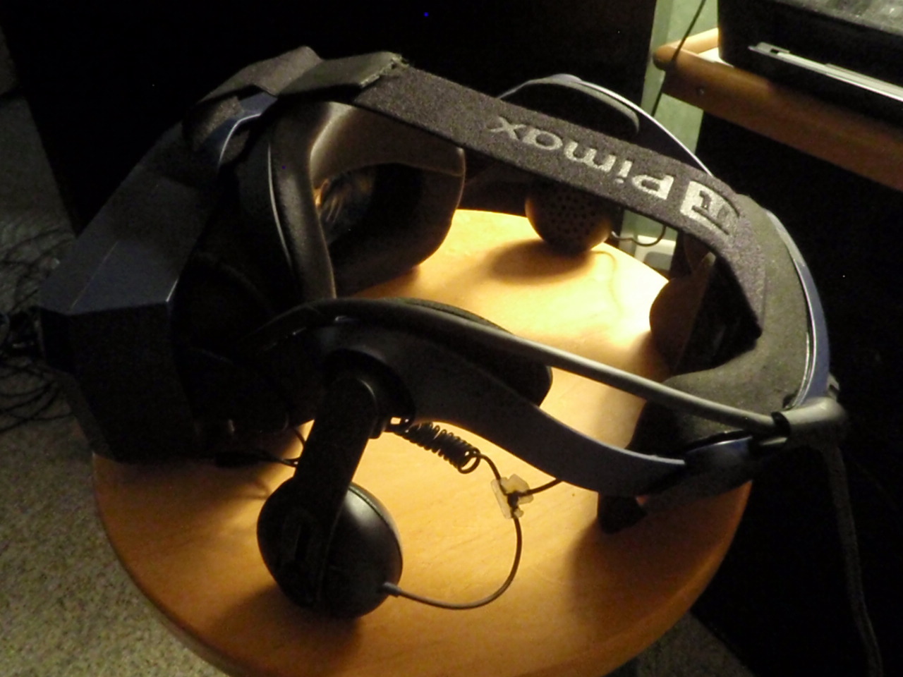

I wasn’t going to mention anything about audio but decided to anyhow. For good or bad only time will tell.
My problem with the audio quite frankly is mainly the volumn level or maybe my aging body and with that hearing. In addition my environment i will describe can be noisy, this summer with temp all month expected in the 90,s my airconditioner blower not far from my place space running continously and with my additional blower fan i use whenever dawning the hmd to provide additional comfort, I simply could not hear anything while in SkyrimVR and that was with all volumn sliders and settings 100%.
I decided to try head phones and they did work but I have always thought that the discomfort they add sometimes from the weight or mearly the problem of getting wires tangled to not use and instead have enjoyed my P8k with the Vive Das.
That led me to this mornings idea and question, can I use the DAS earphones and someway attach them to my new Pimax Vision 8kX?
I saw where someone had demonstrated that the smas speakers could be removed.
So I thought what the hell lets try it this morning. I can’t here in my circumstances now anyway. I’m also to impatient to wait for KD or DMAS, and i don’t mind tinkering a little bit.
Here are some pics and its not a permenant solution and in my case needs some spacers (rubber washers). But the sound and comfort over head phones is so much better now, I went into SkyrimVR just after and the difference was night and day better sound quality wise mainly volumn, wow i can here everything again now!
I don’t mean to criticise Pimax Audio solution for the 8kX it may be okay for some in quieter environments but for me this change was a necessity.
edit: just to add a disclaimer here, if you yourself attempt this somewhat easy mod be aware of what i see as the only real danger is that you could do one or two things. The mod is so far dependent on one very small screw size ph000 and if you loose it well have to find a new one, or if you strip it out you run the risk of permanently damaging your smas and the option to for adding the later KDmas. Maybe someone could find another more secure way without damaging the smas. The screw can also easily come loose over time, so again be aware and perform at your own risk.
Fresco

I was honestly expecting even with the updates that the SMAS was still going to kind of suck, and had plans of trying to mod my Vive DAS into it when my 8KX arrives. Thanks for sharing. Could you possibly share a couple better photos with closeups where it’s mounted?
I have faaar from golden ears, so decided to settle for SMAS to begin with, but have been thinking about maybe trying a pair of 3D-printed cups slipped onto the speaker nubs - not for isolating purposes, but just to confine the pressure from the above-ear drivers… :stuck_out_tongue:
So… Given some of the things that have been said about the MAS Kickstarter Edition: In addition to having higher rated transistors; Does the audio circuitry in newer Pimaces balance to different impedance than older ones? If so: Do we have any numbers? -Kind of wondering if one couldn’t fashion an adapter for grafting one’s Index audio drivers onto one’s 8kX… :7
Razorub i can try to take some more close up shots and upload later, i will say its a fairly simple mod just takes a little time and care, if someone wants to try it themselves i’ll certainly help because it sounds better and really doesn’t damage anything and i still get what i had before and positional audio in skyrim, so i’m a happy camper now where as before not so much.
Thanks. Yeah I’m a bit of a modder myself so I have no issue taking stuff apart :slightly_smiling_face:. I would like to see how you mounted them.
Before pictures i’ll share a few important things to note you will encounter and thinking back the simple steps.
First you’ll need a ph000 size or ph00 screw driver to remove the vive das speakers from its strap and carefully untuck the wires that are held in place in channels (very important save the screws because they are of different in length than the pimax speaker screws.
then just remove the screw from the back of the Pimax 8kX speakers only one for each another very small ph screw, do not attempt to remove any wiring or electronic circuitry here obviously only unplug both plugs at the back of the hmd and leave or tuck where ever you like.
mount vive das speaker in place with wires trailing out back as shown in pic. since there is a pin on the vive speakers protruding i would use rubber washers to fill the gap here, i didn’t have any yet but will definitely need for more long term stability. run connecting wire around back tuck under headbrace cushion. connect to left side plugin. (Done)
