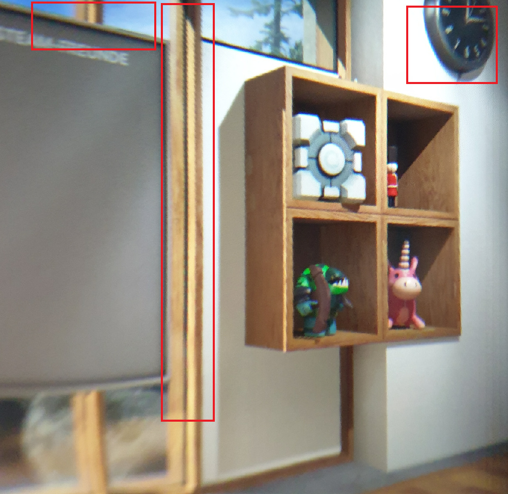

Hi,
while I’m waiting for my P8KX I’m still using my Pimax8K which I’m overal satisfied. The only thing I’m bothered are these kind of alias effects which most apparent are visible at straight contrast lines/edges e.g. in the Anaconda Cockpit in Elite Dangerous or looking at the shelves or at the clock in the Standard Steam VR Home environment, especially if I move my head. Basically it looks like I running it at a low resolution.
my settings: Pitool at 1, SteamVR 100% = 4432x3904, latest NVIDIA WHQL and Pitool Beta
I tried with different RenderQuality and Steam VR SS settings but I can not get rid of the effect even with extreme resolutions.
I’m wondering if the effect is normal and you are facing the same? With my older Pimax 4K the effect is only very minimal and way less visible.
through the lense shots

Hi,
thanks for the info, I already saw your recommendations in the first impression thread of Neonrazor earlier this evening and applied your recommended 12288 for the “maxRecommendedResolution”. Regarding the alias/jagged line effect I saw no difference but will doublecheck tomorrow. So you don’t have these effects with your settings?

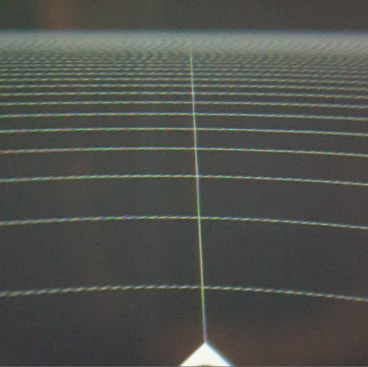

Hi,
thanks for all the replies and offered help. I only had limited time today to test but it looks like the effect increases or at least will be more pronounced with increased resolution. So on higher resolutions the lines are really jagged and, which is more annoying, the lines quite flicker on movement which make the alias effect really visible. So in terms of the issue pitool render quality 0.5 looks better than e.g. 1.5 . I reverted the nvidia drivers to default settings and doublechecked that the image sharping is off. I also confirmed that the 12288 value is set in both the settings file in the Pitool Folder and in the set SteamVR config path. Hardware is a overclocked 4700k with 4 GHz and a 2080ti. The SteamVR performance graph was always green for the screenshots below.
So again my question before I maybe concentrate too much on the issue and going down the rabbit hole - is this a normal behaviour I face?
some screenshots:
Pitool 1.5, 72hz, normal FOV, PP, FFR, Smoothing all off, Steam VR 100% / 5528x4676
Pitool 0.5, 72hz, normal FOV, PP, FFR, Smoothing all off, Steam VR 100% / 1842x1558

I can for starters inform that the SteamVR compositor/dashbard, that you are using as a measure-stick there, will pick a render resolution atomatically at startup, depending on the base resolution and refresh rate of your HMD, together with how well your computer performs in a quick benchmark. There is no way for the user to affect it (other than through obfuscating benchmark results).
So that would be why you see the effect you describe in that case, at least; As soon as you push up PiTool Quality, the SteamVR compositor will reduce its own render resolution right back down from that high target, to keep its imposed load light.
This is also why you’ll see the dashboard get blurrier and blurrier, the higher you set the HMD refresh rate.
For me, the grid in SteamVR (home is disabled) is much less blurry (lines look less fuzzy/more solid) in 90Hz and 120Hz than 72Hz which I used to use before 120Hz was introduced.
