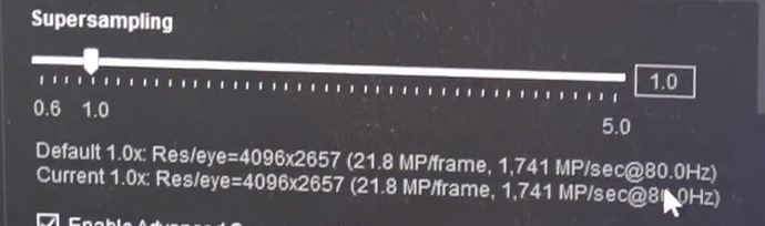

In Pimax Refresh Rate Test 10/30 we can see that the headset is running as default in 4096x2557 pixels/per eye.
We can also see that is in 80hz which equals to 1.741 MB/Sec.

Not according to the refresh test.
Here you can see thats the default rendering resolution.
The input might be 1440p but the rendered resolution is much higher

@destraudo The rendering resolution shown in the picture is the actual size at which the scene is rendered by gfx card. So this is the “real deal” the card has to handle. Then this image is transformed into 2560*1440 resolution by using pre-lens warp transformation and as such is sent to the HMD. Then HMD upscales the image to 4K res of the panel again.
so is what you are saying that it is rendering in 4k, shrinking and distorting and then blowing it back up to 4k.
Actually it is rendering in a bigger buffer than 4K. (4K = 38402160, Pimax for 8K renders into 40962657), but otherwise yes, it is what I am saying.

I would take the info from steamvr with agrain of salt. As we all know, pimax uses their own renderer which does not relate in any way to these steamvr render settings.
The weird resolution alone (4096x2657) per eye with a supposed 1x resolution ss multi does not fit.
If you think there is a 1.85x multi, because 2657/1440=1.85, okay, but 4096/2560=1.6x… does not fit…
The resolution it renders should be a multi of 2560x1440 in both directions…
Yes, it is 4096*2657 per eye as noted in the screenshot you posted. But beware that both eyes are rendered from the same scene geometry with only different view port. So I would expect that the complexity to render those two frames (for the left and right eye) is not so demanding as rendering two completely independent scenes of the same size. But I have no internal knowledge about how SteamVR works, so take it only as my personal assumption.
The supersampling displayed in the slider control is different from the one used for pre-lens warp transformation. They both add in the final image.
In the picture, the “user SS” is set to 1.0, while the “SteamVR SS” is set to the values you calculated. Those values (I speculate) are derived internally by SteamVR runtime from the lens geometry the Pimax layer is reporting to SteamVR.
