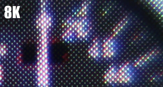

I think the bigger problem is the scalier. If the pixels could turn off correctly the image on the 8k would a lot more sharper.
For example I went in by hand and turned off the correct pixels and as you can see it makes a huge difference in readability when the correct pixels are turned off.
Now a smaller version and a comparison to the 5k:
If we’re talking about an 8K Plus, that would still mean a new panel. There’s also no telling if we would get the right subpixel layout.
A PPD bump is the easiest way to tackle both the sub-pixel layout of the current screen and to address the 11% difference in pixel density on the 5K Plus. It’s not cheap, it may take some time, but it would be way better and way cheaper then a plus model of the 8K, or the pipe dream that is 8K-X.
