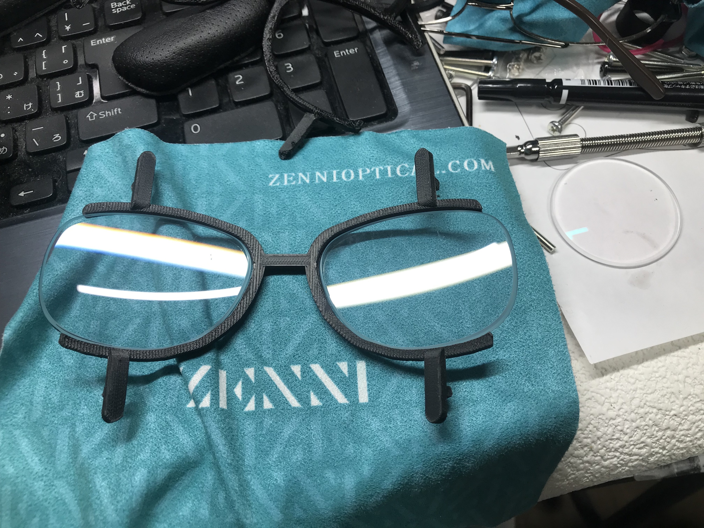

I am creating a prescription lens adapter.
I am testing with my friend.
A wide field of vision is maintained!

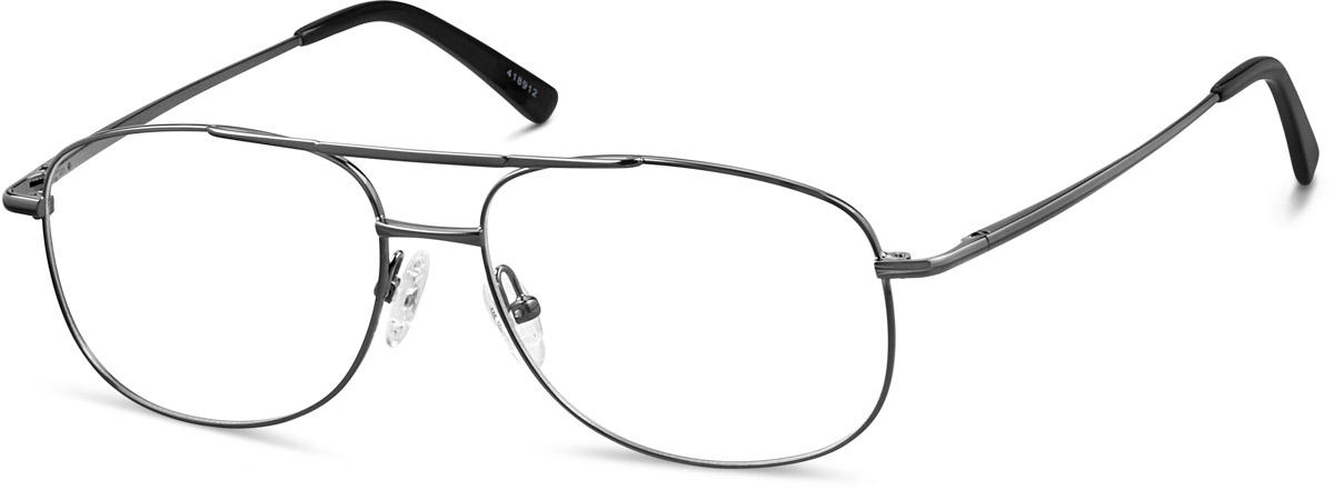

The lens used is ZENNI OPTICAL Model No.418912.
Perhaps the largest lens you can buy at ZENNI OPTICAL.
The price of the standard lens is $ 9.95.
The compatible IPD of 418912 is 65-77, but I also have adapters smaller than 65.

Interresting for peripheral vision, but I have 2 questions:
  • Do you see up and down frame edges?
  • Are you 100% sure they won’t be loose and won’t scratch Pimax lenses? (Vrlenslab Rift adapters also use this kind of attachment and that’s awful)
Thank you for your interest in the adapter I made.
I will buy a new lens for final confirmation. And it will arrive today.
If there is no problem in final confirmation, data will be released.
  • Answer to the question
    Q. Can you see the edges of the upper and lower frames?
    A. It is the same as the glasses you use in your everyday life.
    It will be visible if you look at it consciously.
Q. Are you 100% confident that there is no looseness and will not
damage the Pimax lens?
A. It is designed so that lenses do not contact each other.
However, the thickness of the prescription lens varies from person
to person.
If the lenses collide with each other, you can freely change the
height of the frame.

Here’s the glasses, you pop the lenses out and use it in the 3D printed the adapter https://www.zennioptical.com/p/full-rim-metal-alloy-with-spring-hinge/4189?skuId=418912
Also it looks like they are having a memorial day sale soon. coupon code FRIENDS20 But its not active yet
ah thx 20 chaaaaaarra
Use this lens.
Arrival in Japan was about 10 days from order.
Shipping fee is $ 9.95. It may be a bit more expensive for Europe.
