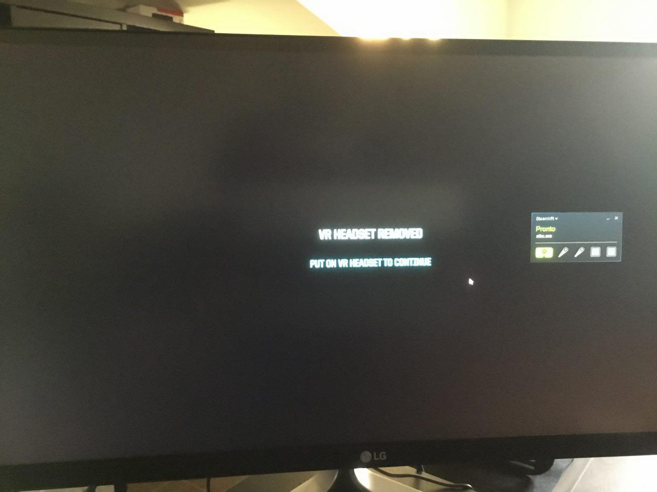

I’ve last firmware, last drivers anyway, in the steam vr list of piplay I’ve Star Trek Bridge crew listed, anyway when it launches this is the issue:

Anyways so I was able to get past the VR Headset removed screen on my Riftcat by using Revive and patching the Star Trek Bridge crew DLLs. Is that what you ended up doing? and if so are you getting a different error now?
I’m running into a different VR Hardware error now using Riftcat at least (at work). I’ll try my Pimax when I get home but just thought I would try to help if I can.
