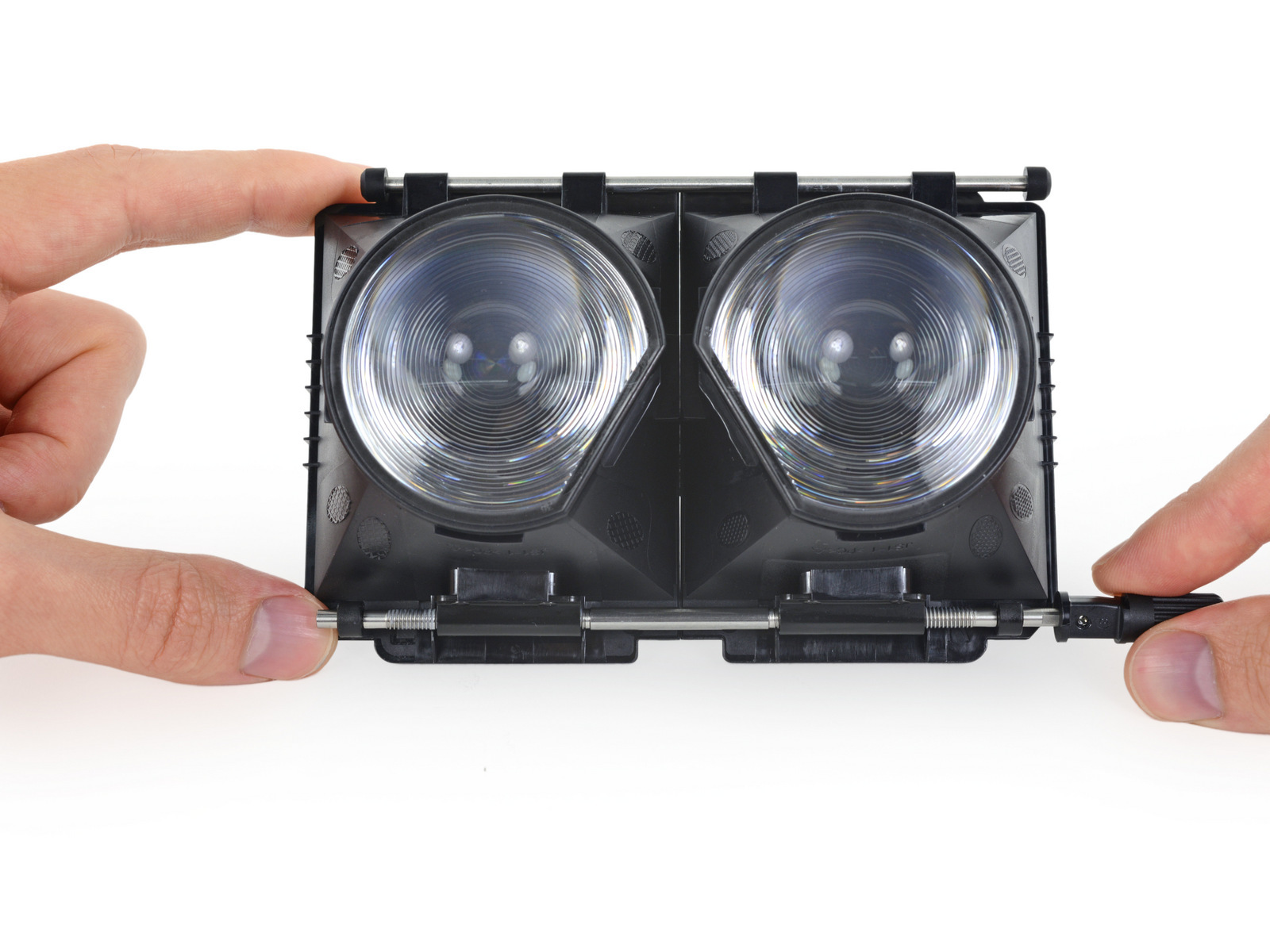

Also @deletedpimaxrep1 if there are really IPD issue’s, then I think you guys need to look into a way to move the lenses + panels. You guys said that your IPD mechanism wont move the panels and I think this is causing a lot of difficult problems to solve. It’s probably MUCH easier and better to just create a mechanism to move the whole lens + panel, just like in the Vive:
It’s actually not that difficult at all and this will make the software algo’s a LOT easier and the resulting quality much higher. After reading the IPD problem comments I really think this is the only way to go. Please have IPD fixed for release because I won’t be able to use your HMD if this doesn’t work correctly. Really a core, key feature. Thanks.

I don’t understand this. The Samsung Odyssey moves the image on the displays in or out with the physical control. It works fine. Why can’t the 8k use the same method? Why do they need the to move the screens themselves? How is that actually different? Either way the image moves.

Well, as long as the lenses do move (this is still unconfirmed I think?) then sure you could make a virtual display panel inside the physical display that’s about 90% of the panel size and then just move that along the physical panel. You’d lose 10% of the pixels though, maybe more depending on the panel size, so it would be better for the resolution/SDE to just move the panel too, like the Vive does. BTW do you have any proof the Samsung works like that? I couldn’t find any teardown video

hmm. i wonder how much the display being canted complicates that. The lenses moving left and right means their distance from screen is increasing and decreasing due to angle. does that mean the headset would have to have distortion correction computed specifically for ever .2 mm step… and its hard to move screens left and right. The extraordinary width of the headset is due to the screens. vive , oculus etc are not like that. to be able to move screens you would need to make headset even wider.
Well if the lenses don’t move then we’re f*cked for sure. No way you can get good IPD control without physically moving the lenses. And the HMD doesn’t need to be much wider, if you can move each panel/lens combo only 9 mm then you already have 18 mm IPD range, so from 55 to 73, that’s enough.

[quote=“sjefdeklerk, post:8, topic:6471, full:true”]It’s probably MUCH easier and better to just create a mechanism to move the whole lens + panel, just like in the Vive:
It’s actually not that difficult at all and this will make the software algo’s a LOT easier and the resulting quality much higher. [/quote]
The Vive solution only works because simple rods link the 2 lenses which are aligned to each other on a plane. Unfortunately, because the 8K lenses are at an angle to each other, this technique won’t work. The top guide can easily be split, but the lower rod will need some way to connect the 2 worm gears. This could be a universal joint, like a car’s drive shaft or a spring, like a flexible joint screwdriver.
I don’t think you need to move the screens, but you probably want to move the lenses, because for best viewing, the center of the lenses need to match the center of your eye’s pupils.
Given that quite a bit of the screens are supposedly past the FOV of the lenses, there should be plenty of room to just shift the image to the side on-screen, to match the physically moving lenses (Again: The lenses seem to be parallel with the screens). In fact; Given physically fixed screens, it would (but will probably not be done) be possible to improve stereo overlap for people with high IPD.
