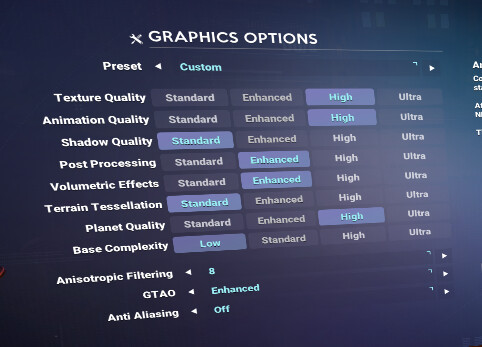

I finally have this one playable on an 8KX with rtx 3080 at 100% steam ss with pitool: pp off, smart smoothing off, fov potato (just pretend you’re wearing a space helmet), native 75hz.
Looks as good as flat on a playstation from in headset with these settings i’d say.

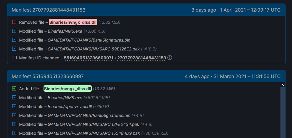

source: https://steamdb.info/depot/275851/history/

my cpu is an i5-8600k and was only able to hit the 75fps target with potato fov and 1.0 render scale in pitool and 100% ss in steamvr.
normal fov would probably work with planet quality low, but because i prioritized hitting planet quality HIGH with the better post processing and volumetric effects i made the trade off for the smallest fov. which obviously isnt ideal, but it’s sufferable in this game only because it doesnt destroy the immersion since your character would already be wearing a helmet with limited visibility.
for me this looks really good, very sharp and smooth but also very immersive with the necessary graphic options cranked up.
crossing my fingers when/if we get DLSS support on this one that we can go for normal fov all other settings the same.

With my 2080 Ti I’m running exactly the same in game settings as SethW (except for Base Complexity Standard), but with Small FOV and Motion Smoothing On. It’s a rock steady 37/38 everywhere, which wasn’t possible before with PP On, even with reduced settings.

Now I use your settings 1:1, and it is excellent 99% time. FOV must be potato, and settings must be as yours. Sure I will play this game more :slight_smile:
