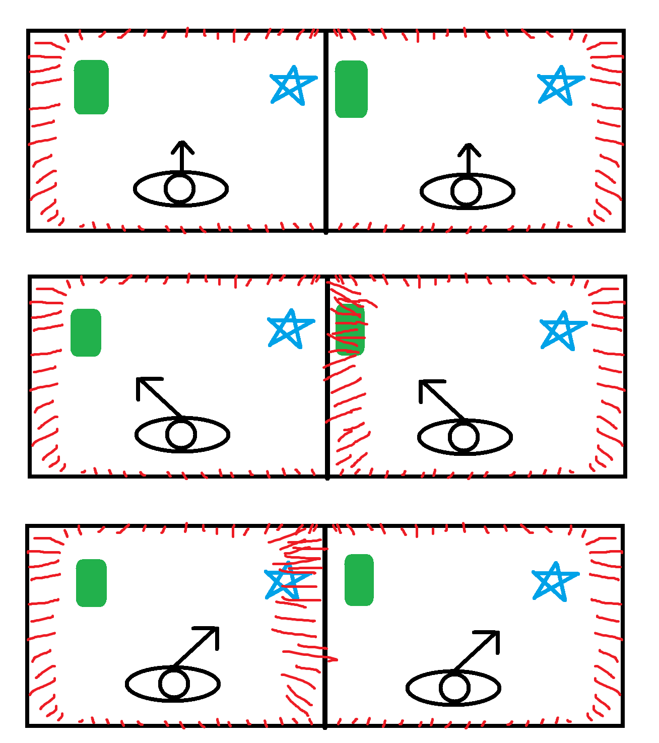

ok, as for me it’s no different, by the way 5k + and artisan didn’t fit my friend and he complained that he sees distortions on the lenses around the edge, here’s a picture from him, I think you’ll guess what he meant by the average distortion of his IPD 70.
I do not see distortions just a little bit of the edge of the left and right edge.

But he seems to describe distortion at the center which is different, is the IPD not set too hi? And even with this not sure it does that.
my IPD is 61-62 and I also see only peripheral vision

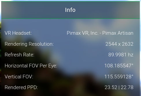

FOV normal normal
FOV smal smal

I guess by distortion, you mean it is becoming blurry. This would correspond to the fact that the lenses are canted and when looking sharp to the nose side you are looking through the peripheral ring of the lens which is also canted (in a wrong direction).

And/Or due to his ipd much like on the rift s being to close to the end of the physical ipd range.
