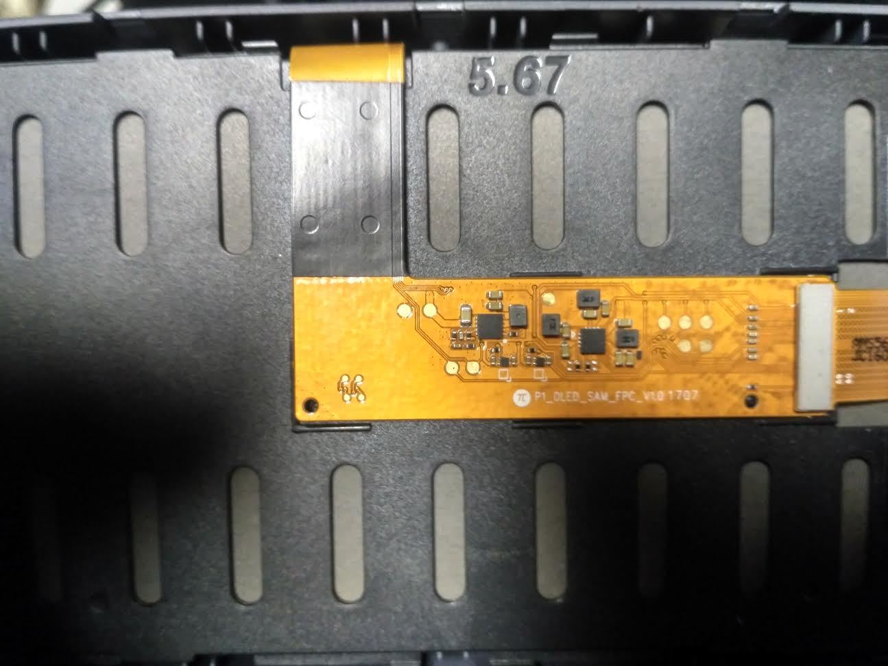

There are at least 2 different type of display panels used.
I own 2 pimax 4k headset serial numers starts 102xxx and 100xxx they clearly have different panels in them.
sn102xxx have maybe little bit more screendoor effect but have no ghosting at all.
sn100xxx have less screendoor effect but have awfull ghosting.
also i can clearly see different kind of pixel patterns with both headsets.
here are picture from back of sn102xxx headset does it look same in other headsets? could this be oled pimax 4k?
i will not disassemble other of my headset (i try to sell it)
i did buy both of them from gearbest
at lest this youtube video shows different internals.
Boxes seem to be different too. different fonts and sn100xxx have red color and sn102xxx have blue color.
Very interesting. Maybe @PIMAX-Support could enlighten us over the hardware changes/improvements with the 102 series.
The old model uses a sharp “rainbow” lcd panel.
Yeah after you mentioned it took a look at the pic n saw the oled.
That’s extremely interesting ! It says OLED ! Do the new Pimax versions actually have OLED panels !?!?
Agreed, I’d sell my Pimax right now and buy one with OLED :slight_smile: Or are they maybe not 4k !?!
@PIMAX-Support @deletedpimaxrep1 can you enlighten us about the new panel type ?
Man ! I really wonder what panel this is. Maybe it even supports 4k without DSC compression ? The only reason that the Sharp panel doesn’t support it, is that that panel only supporst 2 data lanes. Maybe this new panel actually has 4 data lanes, which would mean that it would support 4k without compression ! So it could be enabled right away.
