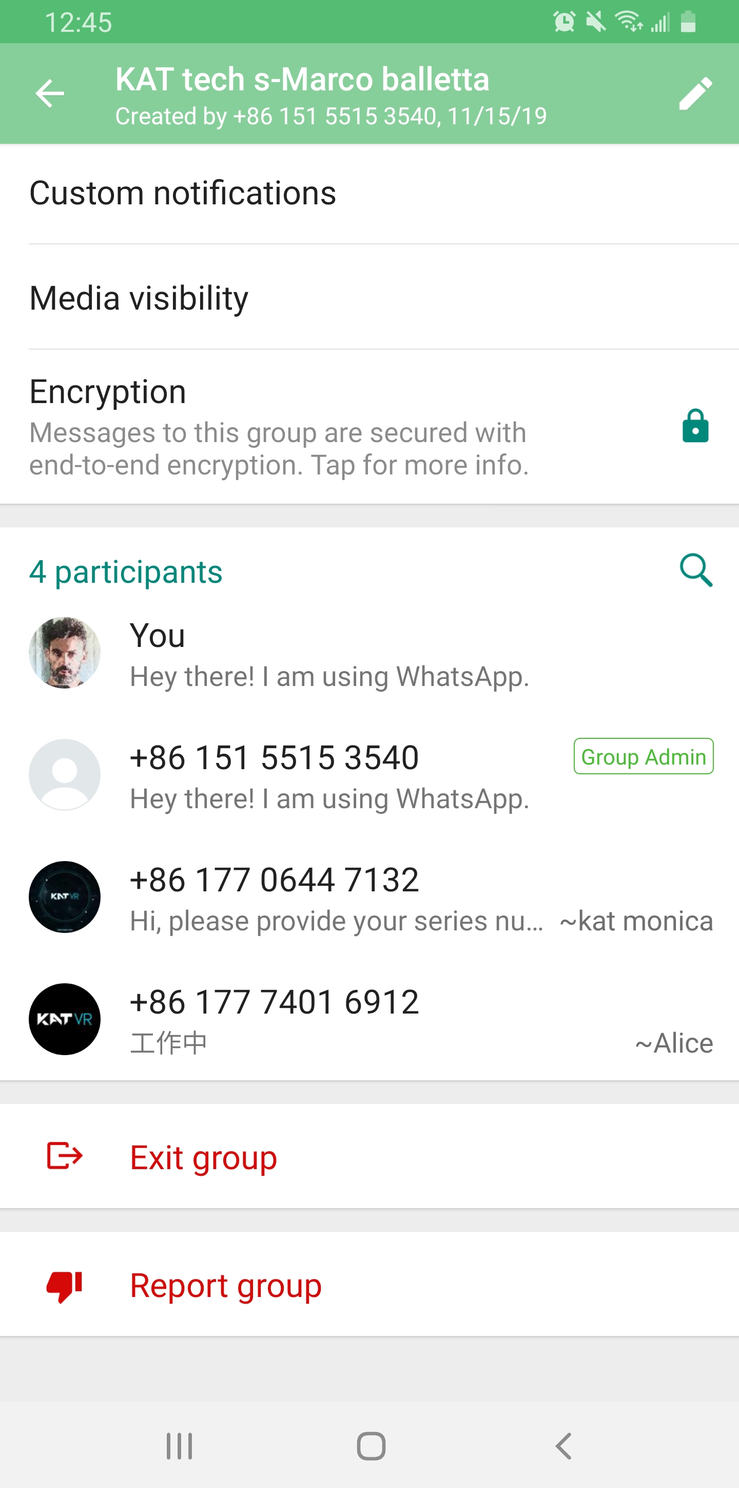

Hi. You can also contact directly the tech support. They are on whatzup and they usually reply quickly.
They help you to set the device up and with any problem you might have with specific games.
I strongly suggest you to contact them and to not just give up. I had issues too to set the device up because of a software error in their setup. They logged in in my PC and fixed the issue. They have made now a tutorial for us to fix the problem
