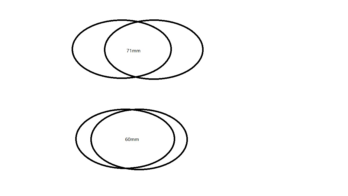

Still struggling with IPD and binocular effect. Recently I remeasured my IPD and found it to be 71mm. So I set my Pimax 5K+ to the maximum 71mm. The binocular effect is quite obvious as shown in the attached pic. Then I reduced it to 60mm. The whole FOV becomes a bit smaller, but it has less binocular effect. The FOV of each eye is more concentrical and there is bigger overlapping area in the center. (see the attached pic)
Now I am completely puzzled. 71mm or 60mm, which way should I go? Which is the right adjustment? Shouldn’t a perfect IPD setting results in a perfect (minimal) binocular effect? Yet my test does not seem to conform to the assumption. Looking forward to your opinions.

I can’t agree with you on that. Subjective experience is important, but it is not enough. We still need objective fact and scientific knowledge. There are fuzzy areas that we are not sure of and have to seek help from scientific support. For me 60mm and 71mm are both acceptable and I don’t know which is right or which is better. One of the choices must have less eye strain but I am not sure which is it. In the long run it must have some impact on the health of my eyes even if I can’t fully notice it, and I am anxious about that. Of course I will not fully rely on measurement, and that’s exactly the reason I am asking help here, otherwise I will happily live with 71mm as that’s exactly my IPD measured at the optometrist. I believe in personal experience plus some guide from other people who have better knowledge, which will shed light on my confusion and make me relax.
I think people should be aware of main thing that happens when you adjust your IPD, aside from perceived sharpness and binocular overlap. I borrowed this from the internets because it explains it nicely:
“The 2 viewports (or virtual eyes) in the game should ideally match your own IPD to pass the correct perspectives and depth to your brain. By adjusting your IPD settings in the VR headset, you apply a correction to offset the rendered distance between eyes to match the IPD your brain is expecting. While the correction isn’t perfect, and results in slight perspective distortion the further you correct, VR headset IPD adjustment is good enough and it allows us to see the ~correct depth and perspective as intended.”
So the further you stray from your real IPD the more you are robbing yourself of correct depth and perspective perception that your brain expects from real life experience. Scale will be off and immersion will most likely suffer as a result.
