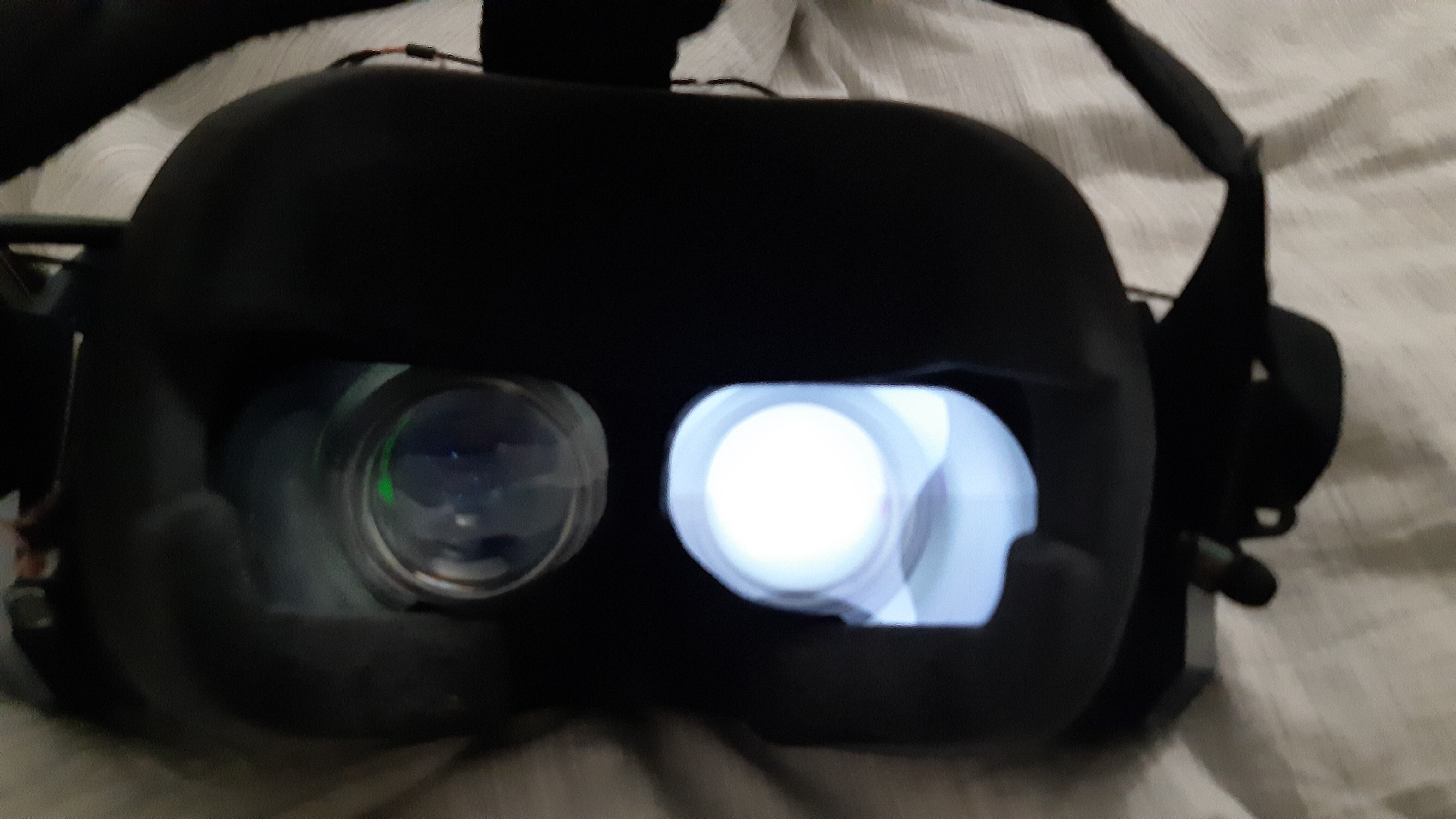

After the pitool shutdown, computer restarted or similar, and then restarting the pitool, the screen colors are often reversed. This happens maybe 3/4 probability when restarting the headset.
Usually they are initially both displays reversed in color, so that the screens look like a negative image (black->white, white->black, yellow->green etc). After restarting pitool or clicking “reboot HMD” it usually fixes one of the displays but rarely both. After several reboots, restart service clicks, or restarting pitool it by luck starts up properly and then the colors are normal again until next time the headset is shut down and restarted.

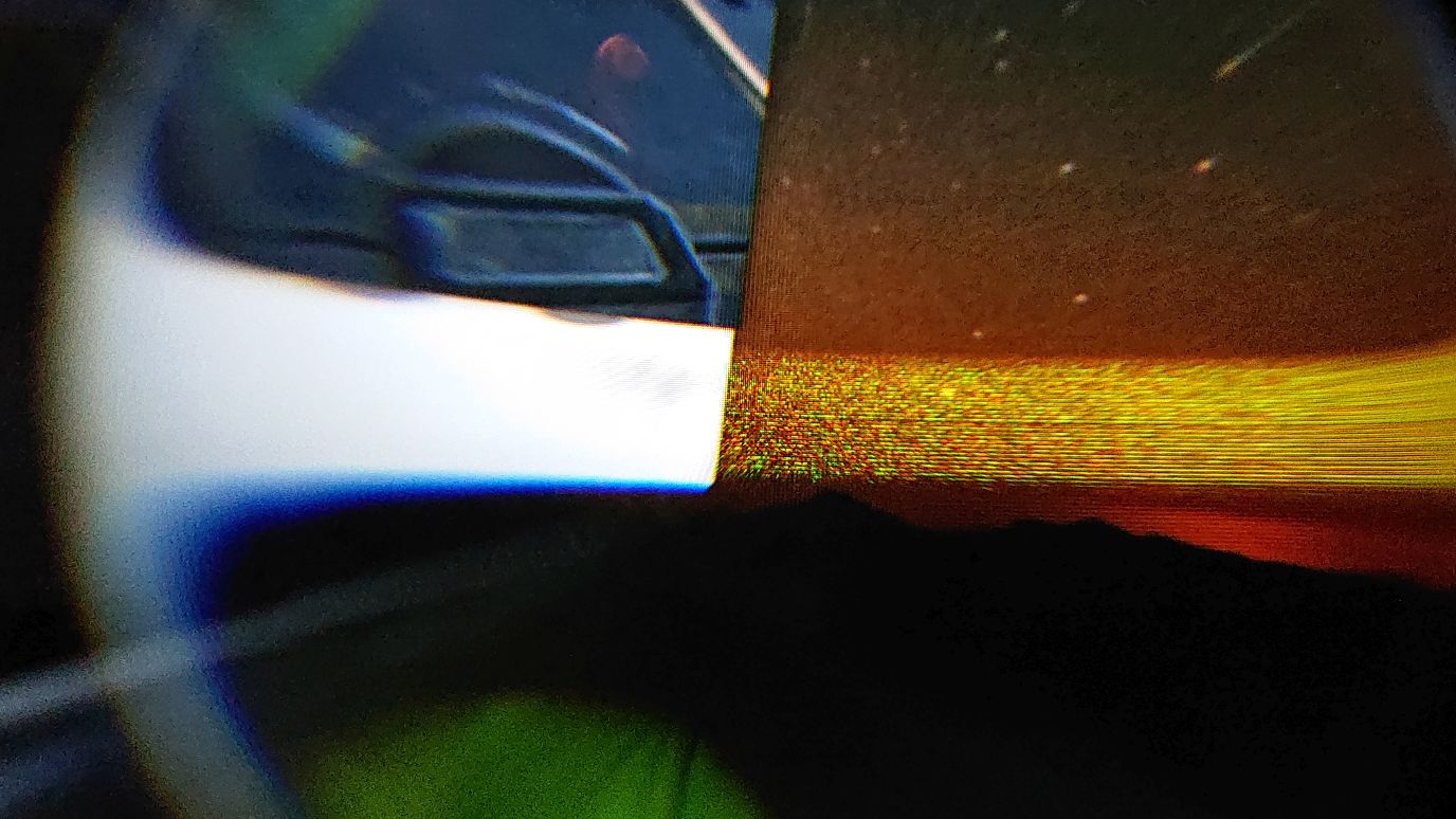

In addition, sometimes there is a weird colored randomly pixelized fixed horizontal stripe pattern that is triggered by bright areas in the image. I’ll try to attach an image of it.
It randomly appears on right or left panel at HMD reboot. It also goes away by performing HMD reboot. The side it appears on varies. Another indication that panel start-up routine has something wrong.
In the pictures there is a small window of Elite Dangerous with white title bar that causes the artifact on the right side of it.

Here some pictures of how it looks :
Hope it can trigger some advices…
