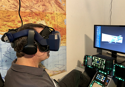

So I tried the DAS modification for my 8KX and it works better than the original speakers. But, they do not line up with my ears and just in case you do not have a DAS you want to take apart and wanted to try a different option. I found these little speakers on Amazon for around $43.00 and then designed a spacer mount to be able to replace the existing speakers.

So the more I use them, the better I like them!
working
so you got also the wrong hinges on your pimax 8kx i see,its way to high on your back off your head…
Pretty comfy though once I got the top strap set correctly. My 5k Plus with the DAS mod feel a little nicer. It would be interesting to get one or two more clicks down with the hinges - I would not want more than that as they feel really good now with the counter weights. Not sure how to mod those so hopefully someone will make it easy to swap out with metal ones with more range.
