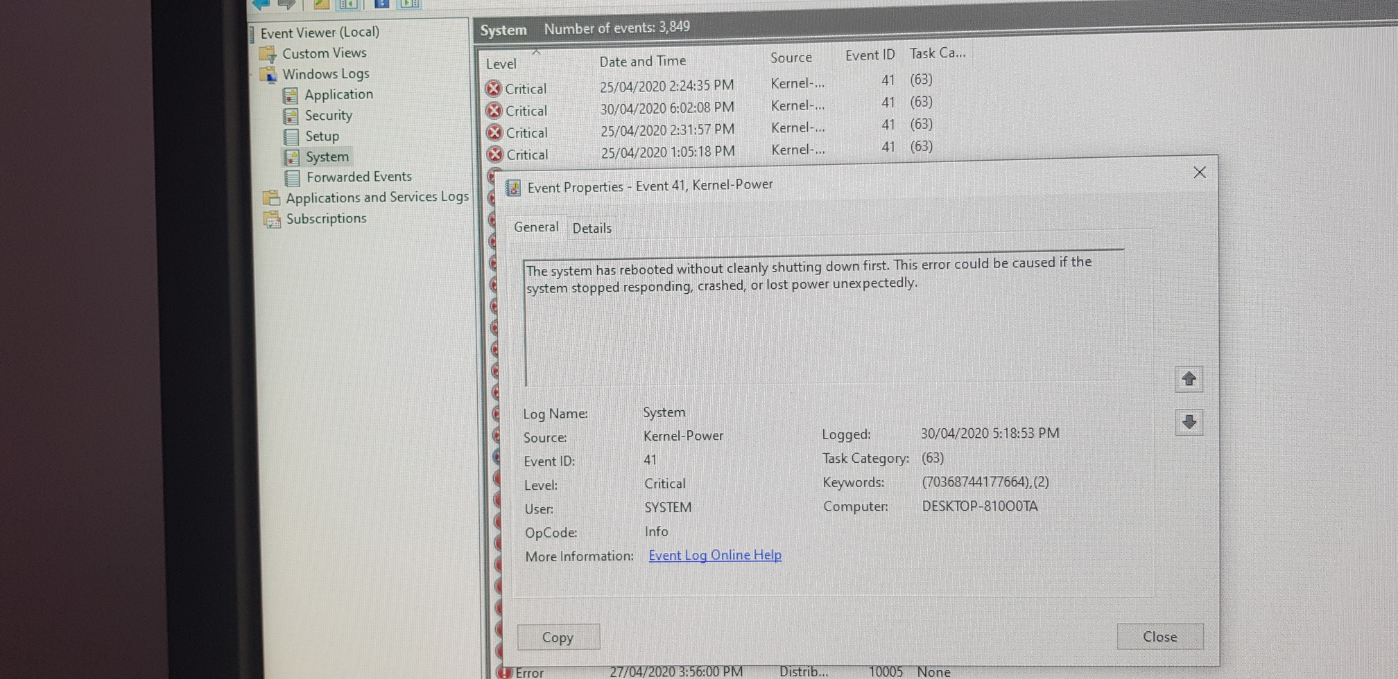

And before you even do any of that, have you checked the Windows Event viewer on reboot to check if that recorded any problems before the PC crashed? There might be something logged in System or possibly Application, but not always in a severe BSOD crash:
Yeah that’s the right place, is that the first timestamped error before the crash occurs? Unfortunately the pic error just states that there was an unexpected crash, which doesn’t enlighten us much You can sort by Date and Time, and then also filter the results for only Critical errors under the search option. But don’t worry too much about that, there’s probably not much there.
