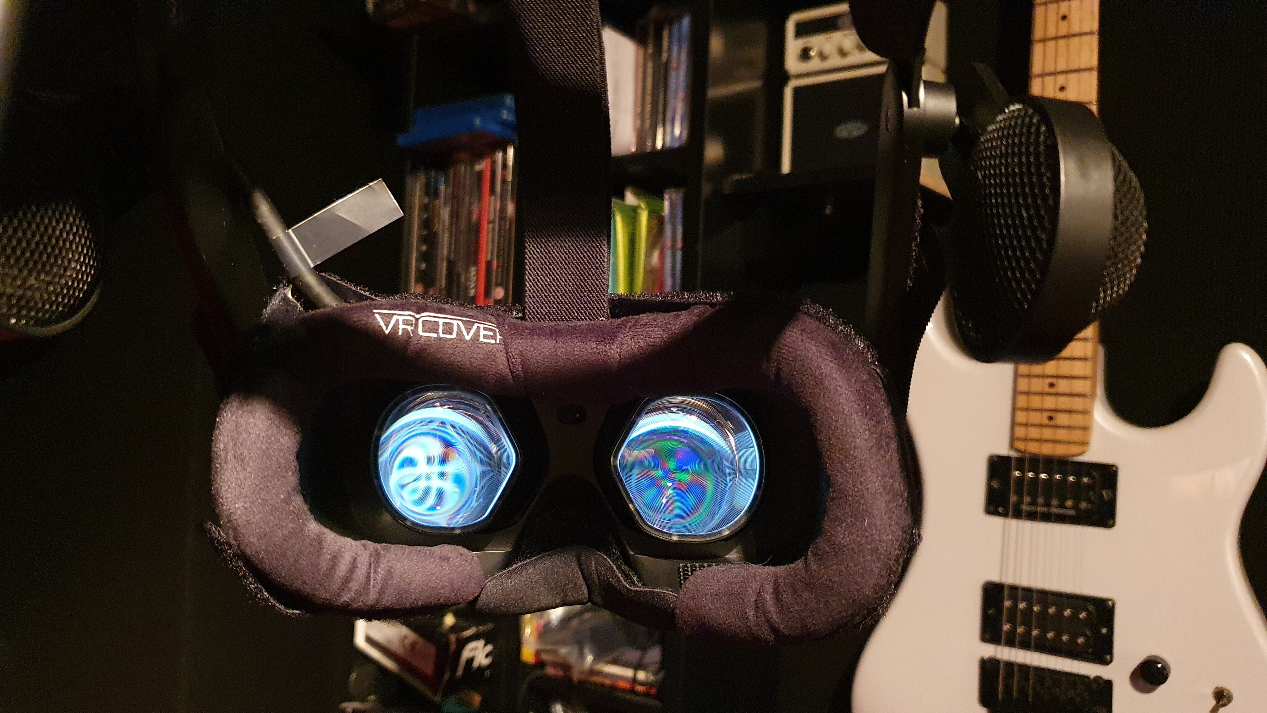

@Djonko i made my field off view mod also.
The stock faceplate was to narrow for me it didnt fit.
I modded it now with a vr cover(dont remember wich one ,but a very very soft one)
The official faceplate is completly removed.
Because the hp reverb is already so light its even lighter and more comfortable now!
Just put it on my head and its good to go…
And now i have the field off view that i wanted and a even better sweetspot .
with ofcourse remaining the amazing clarity and colors.
I did put some velcro on top also if i get some possible lightbleed,but it wasnt needed yet but just in case it should happen…

By the way i used this very soft cover @Djonko
https://vrcover.com/product/samsung-odyssey-foam-replacement/

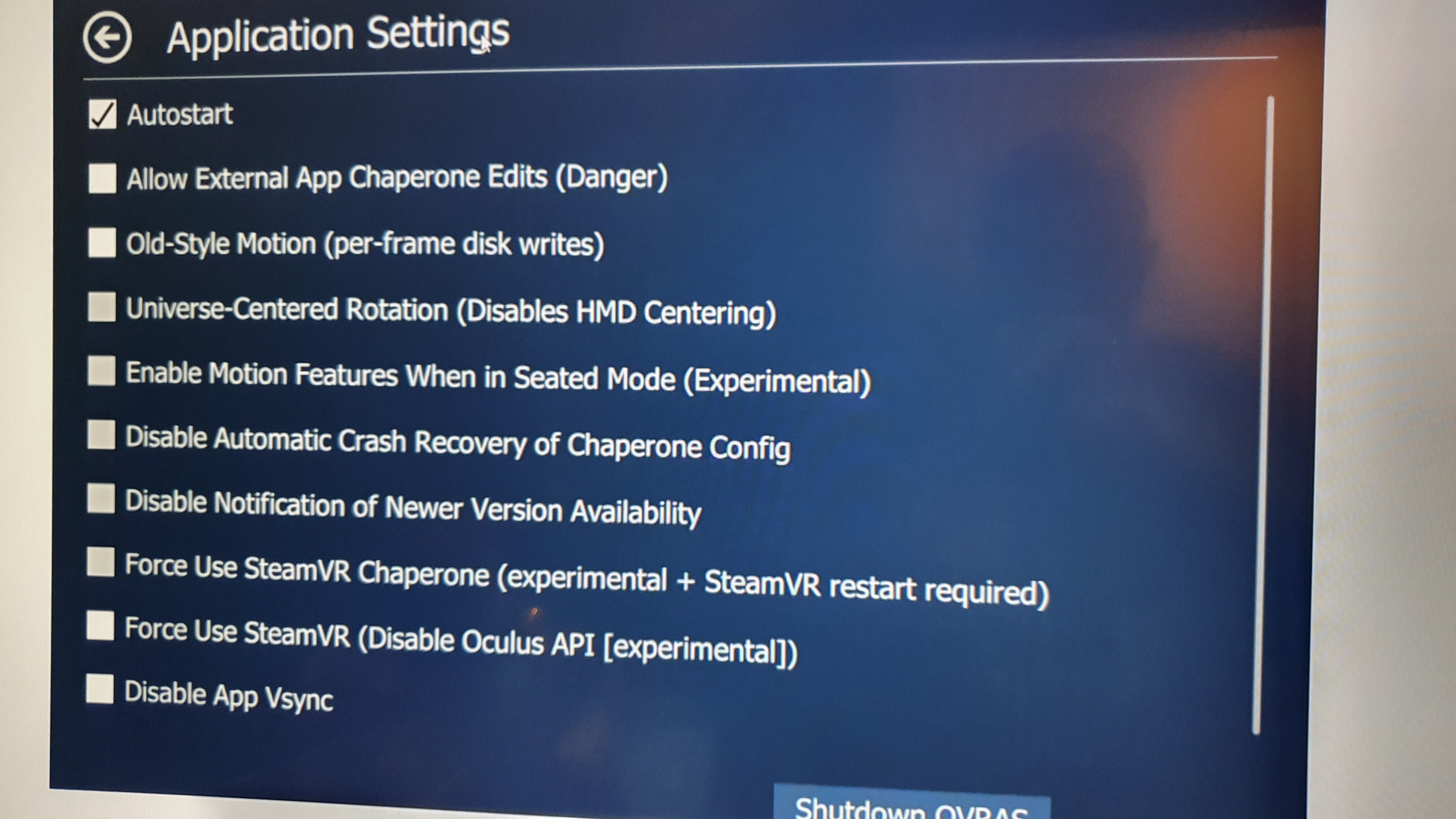

By the way if u use the same methode as me(the valve index as a bluetooth transmitter with open space calibrator) to use your hp reverb g2 with your index controllers.
i found out there some games(not many) what gives a grey screen.
You need to disable boundries in the windows mix reality portal.
And use the latest open vr advange settings for steam vr,
under settings enable: force use steam vr chaperone(experimental+ steamvr restart required)
The only downside is when you start steamvr it asks for a room setup,but this you can close and everything works perfect.
Now whith the facemask mod and the index controller,this is my headset to go for now…
