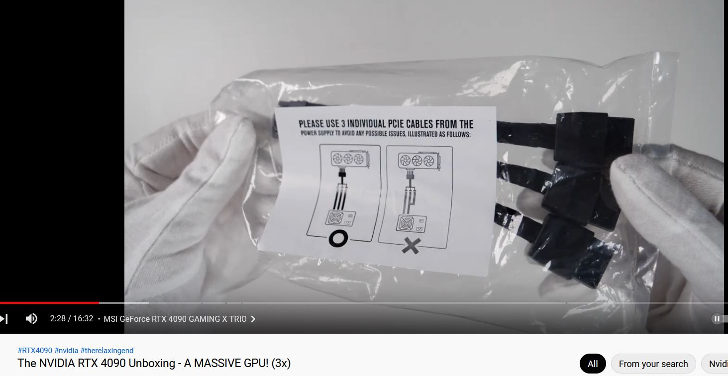

I know with my 3 x 8 pin MSI Trio 4090 it came with a warning leaflet saying not to daisy chain PCIE cables. It said to use 3 separate PCIE cables, here’s a pic of it from YouTube :

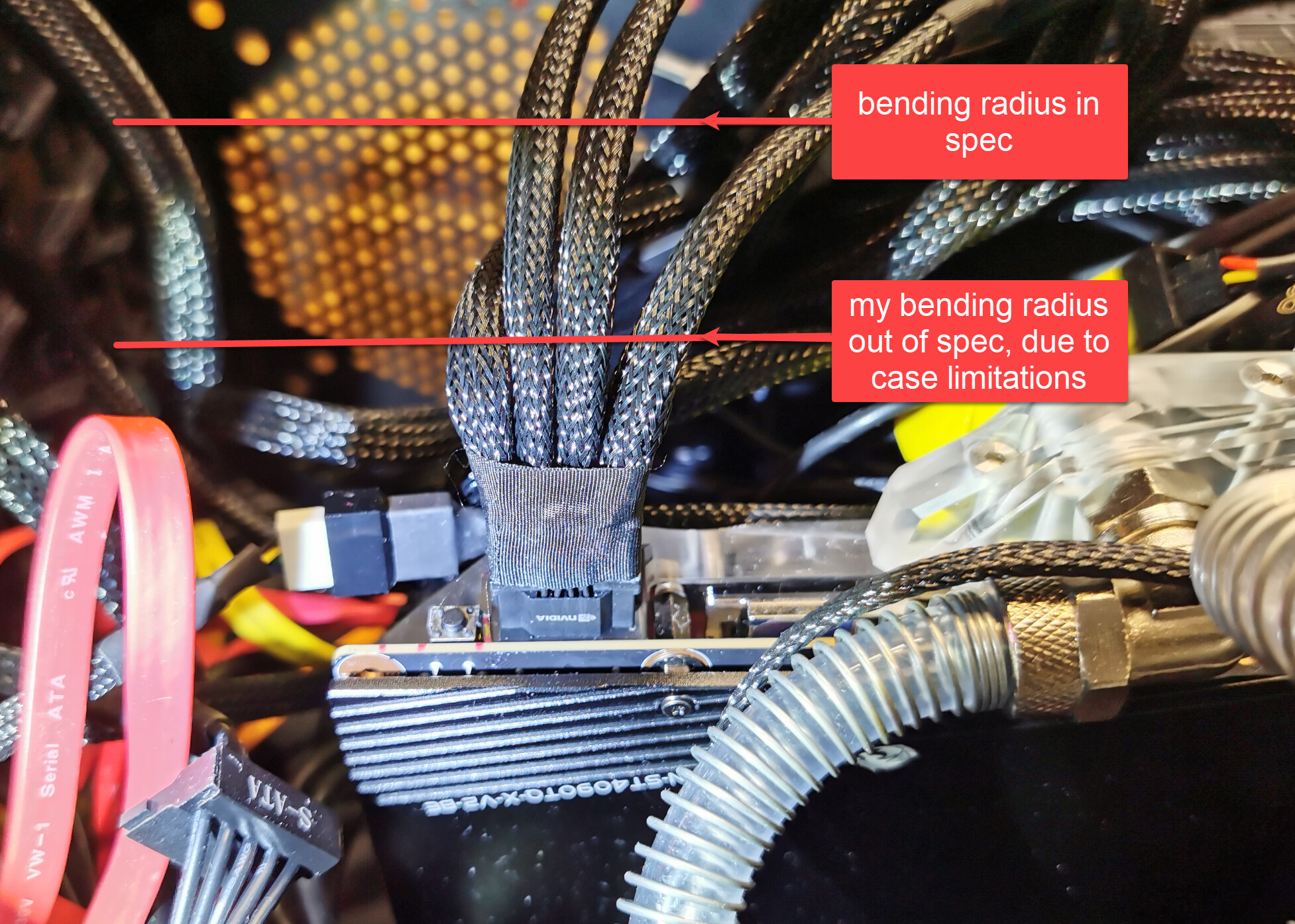

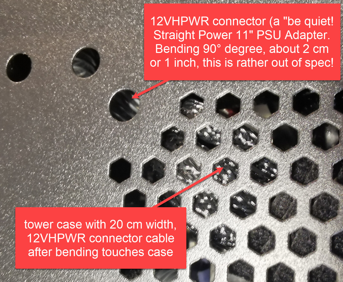

Where did I advise people to do so? - The opposite is true, I told every user with a 20cm width case (like me) is out of spec, regardless of a technically possible carefully applied narrow bending. Which causes potential warranty issues in case damage. That´s what I told, just look above. The thread opener has a bigger case, which we didn´t know in the first place, so no issue with this.
At least, this discussion shows the 12VHPWR connection is on the edge.
I illuminate the problem with my solution, a picture from outside into the case:
I did it, but it is not in spec as the cable supplier be quiet! told here:

one pic to visualize the case / tower width based issue
Therefore I registered for the CableMod 90° connector , another shorter cable I would like to order, but all out of stock everywhere, beyond some scalper offerings.
edit: photo taken during mounting…
