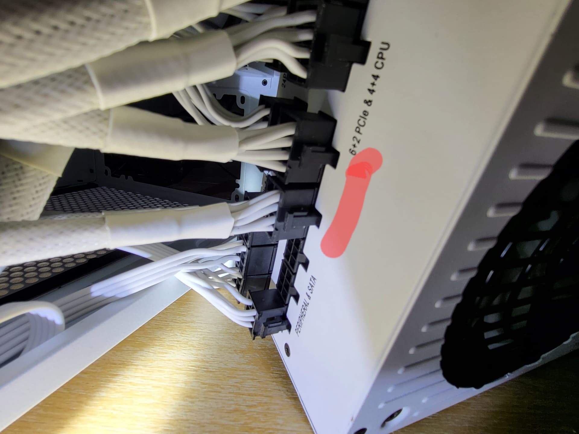

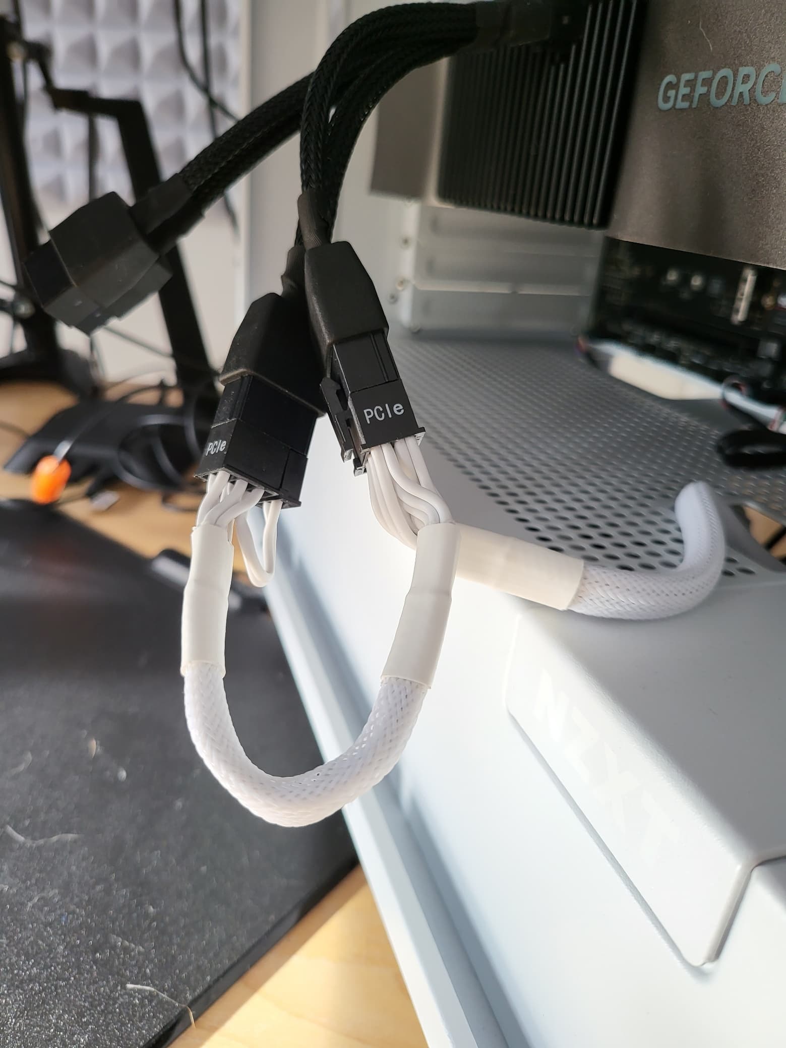

Card is here- just installing. The PCIe Cable has 1 plug on the power side - and 2 on the other side. so i only need 2 cables or really 4 going out of my power supply?
Not sure can you post pics? Sone manufactures like Gainward? removed the original 12vhp connector to maybe use something like your describing.
Here… Another Problem i see is that on my power supply i only have free space where peripheral/Sata is - not where pcie is listet- is it ok to plug the pcie in there too-- in the picture they kind of look the same
Edit: I found no clear answer. But one guy sayed to not use one cable that goes into 3 but at least 3 dedicated plugs in the power supply…
So i used the 2 remaining that i have … What worries me a bit is that nvidia says at least 3 – do you guys have 4 dedicated cables? Will the performance or anything else suffer?

On your Psu/picture you posted, there are 4 available 8 pin outputs? Do not use 6-pin SATA outputs, they have different voltage/pinout (!)
I plugged them in there on the right under periphals and Sata…they were 8 pin slots

You need 4 individual power cables coming from the power supply, one going to each of those 8 pin PCIE connectors on the power adapter. What you’ve shown in the photo is wrong and potentially unsafe as you’ve daisy chained a single power cable into two plugs on the adapter. This is running your white power cables at double their rated capacity.
Those cables can typically handle it anyway which is why you’ve been able to boot it up and play games this way. But it has not been cabled safely and properly.
They look the same, but they’re actually keyed so that you can’t plug your power cables into the wrong ports.
Yeah, that’s totally ok. I thought you somehow was able to use a 6-pin or something from the PSU. Using 3 individual cables from PSU is recommended, even though it should not affect performance as long as the 12V rail they are connected to are able to supply enough power. I belive you have the FE? My Gainward came with only 3x8pin though. You will need the 4th cable if you plan on overclocking. Running the card stock you only need 3. Worst case with the splitter is you get higher temperatures in the cable/plug if using one that splits into 2x8pins as you are running them above spec. I’ve been running 2x8 pin @540W for the past year on my 3080TI, nothing cached fire, even though it is not ideal…

It seems that here are to oppionion … one of you says its ok to use the cable with the 2 plugs the other says its not… I can only run 3 cables… So i could do 2 just one pluged in the card and the last cable plug both ports in?
Yes i have the FE
Using 3 single cables will give you 100% power limit for the card, aka full performance. If you want to maximize overclock, you would like to increase the power limit for the card above 100%. To do this, it will require a 4th cable to be plugged in, without it you will not be able to pull power above the 450W already available through 3 cables (100%). The 8 pin PCIe connectors are rated for 150W each, even on a daisy chained cable (total of 300W max on that cable). So, if you want to overclock, you can still connect all 3 cables and using a daisy for the 4th. But stock, the card will not require more than 3 cables to perform at 100%.
All 4 plugs connected will allow the card to pull up to max 600W (may only happen if you overclock and raise the power limit manually iirc, but even then I have not seen overclocking pull that much power) Although, with a 850W PSU I would not recommend overclocking it at all. Just run the card with 3 connected, you’ll be fine. There is not much performance left on the table by increasing the power limit to 600W anyway as these cards are limited by voltage way before power limit is hit.
