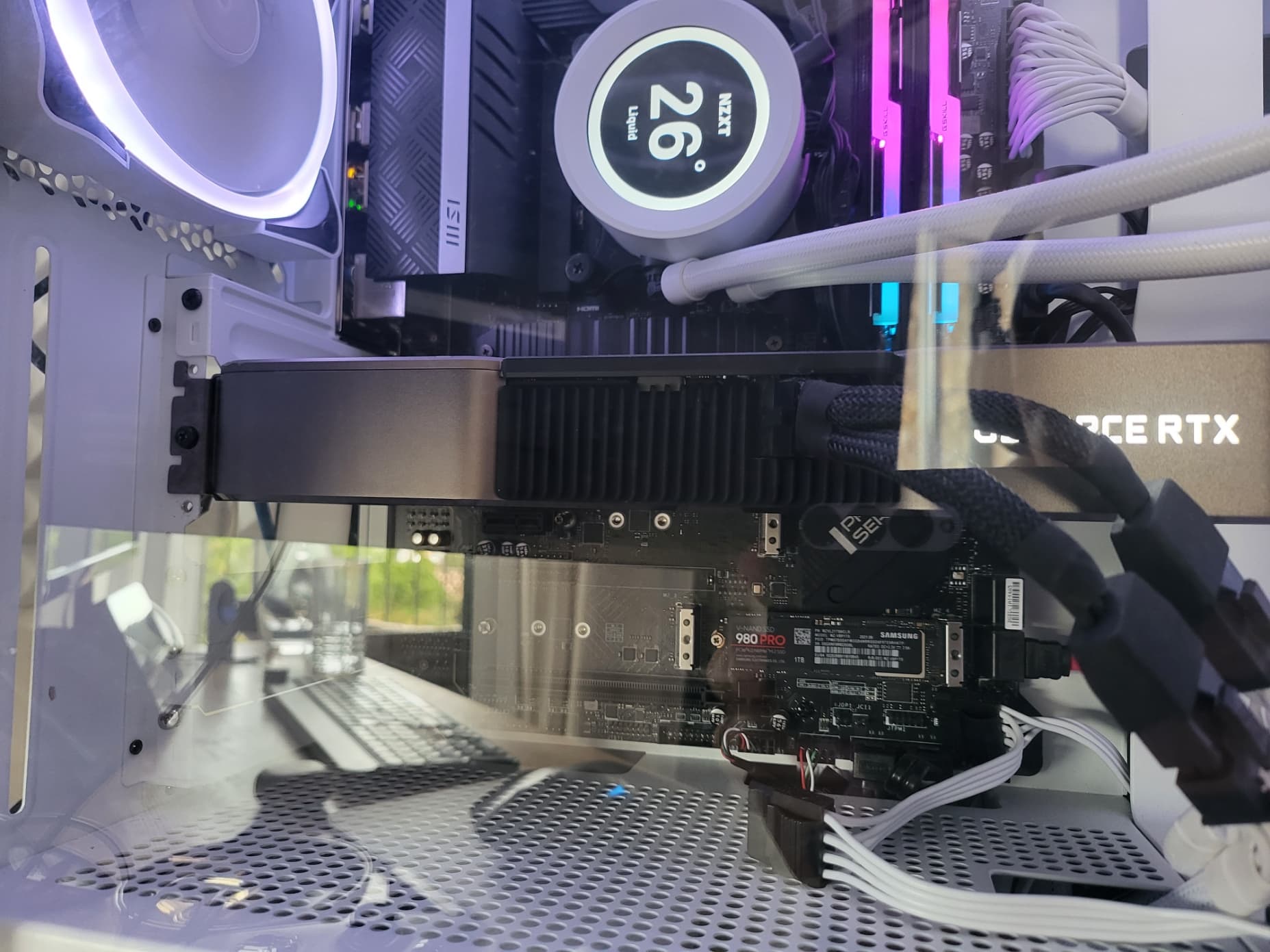

I think i found the cables… This?
yes, the 1’s for your psu to gpu should have PCIE written on them, they are 8 pin (6+2).

The term 12W is the single cable, with a single socket on one side 12W and which on the other side has 4 8pin / pci express sockets.
It will be in the box of your graphics card, at the other end of this cable you will see 4 8Pin pci/express sockets
On your Rtx 3080TI you had 3 8pin pci/express sockets, you will need to plug one more into your power supply (cable in your photo)!
So you will have 4 8pin pci/express cables that will go from your power supply and that you will plug into the famous 12W cable
-So when these cables 4 cables will be connected to the 12W cable and its 4 sockets, there is one thing not to be missed:
-The 12w socket that connects to the graphics card, it is absolutely necessary that the socket is fully clipped, those that we see on the net who have had a problem with this 12w socket is due to a non-clipping at 100 % .
And that’s it, it takes 5/10 minutes to disassemble your Rtx 3080TI and install your new Rtx 4090.
