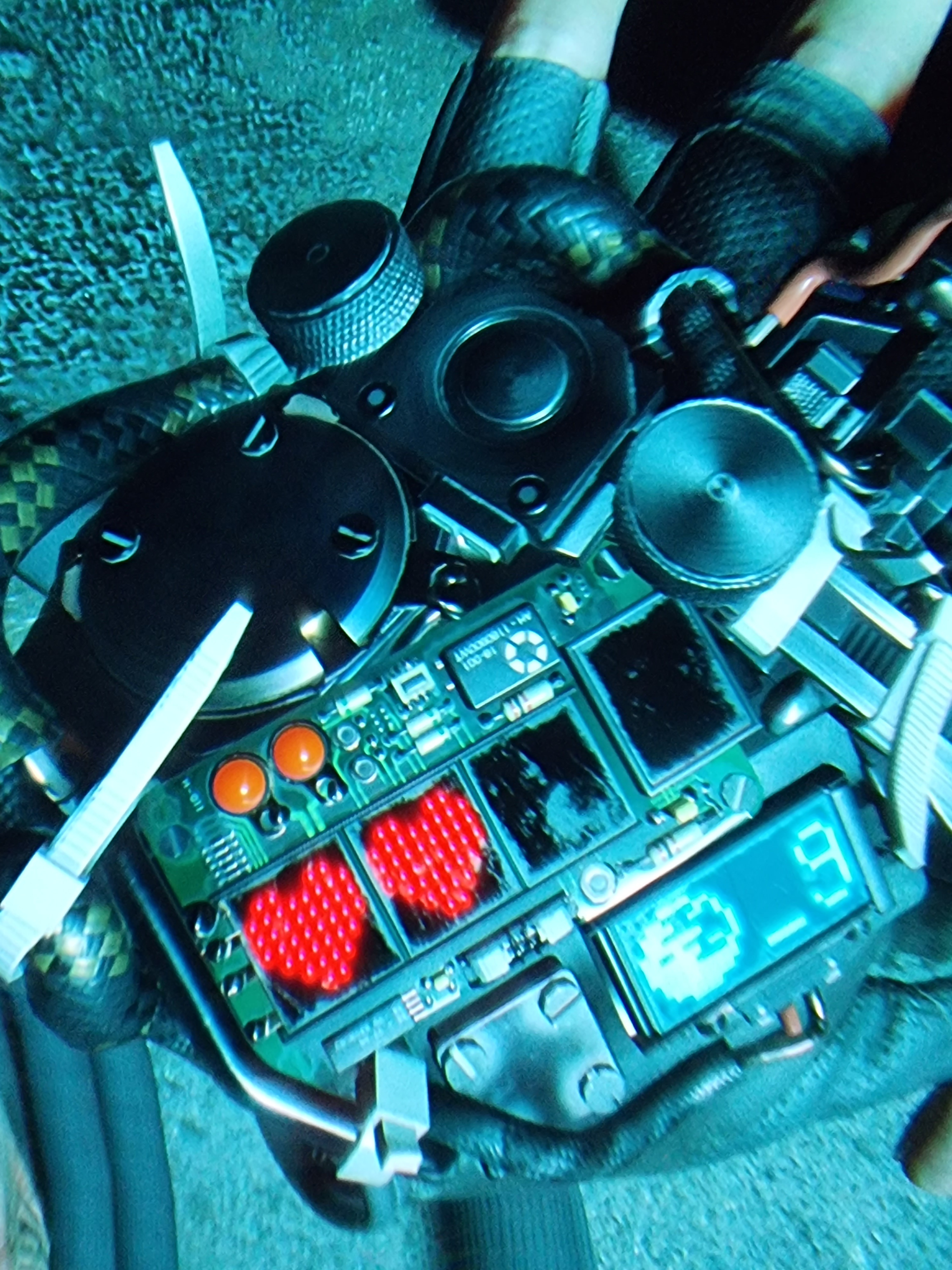

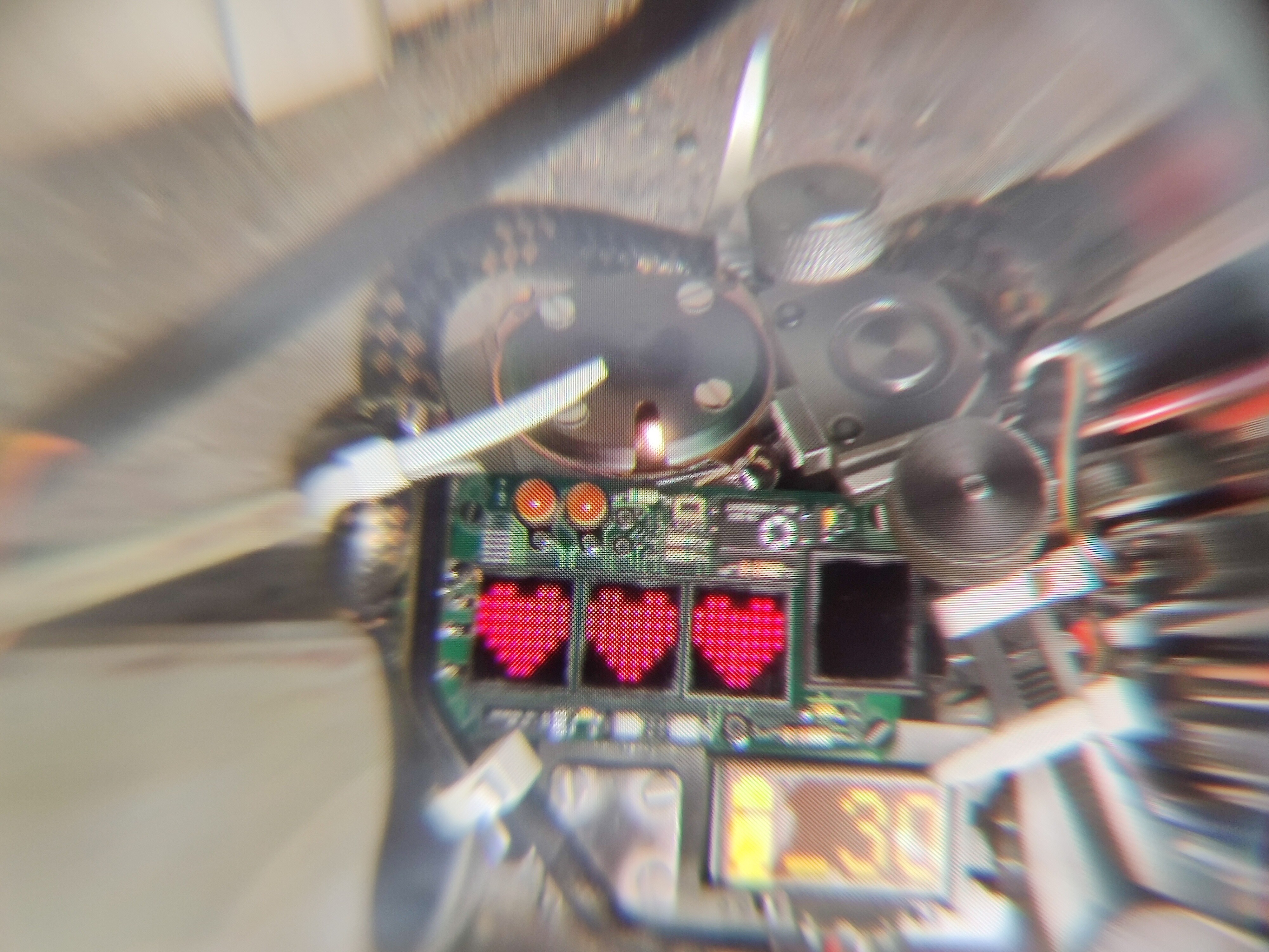

Thats through a pimax Xr oled ( 5036x3172 ) 150%SS large fov pi tool render quality 1.0
Which one? As far I know then mainly improved via contrast and brightness, not color saturation or gamma. Did I miss something? :open_mouth
I meant that one , he is saying the colors do almost look as good as on the reverb G2 :thinking:
Lol, yeah the SDE on the XR is not great
yeah, did that, the colors still suck big time

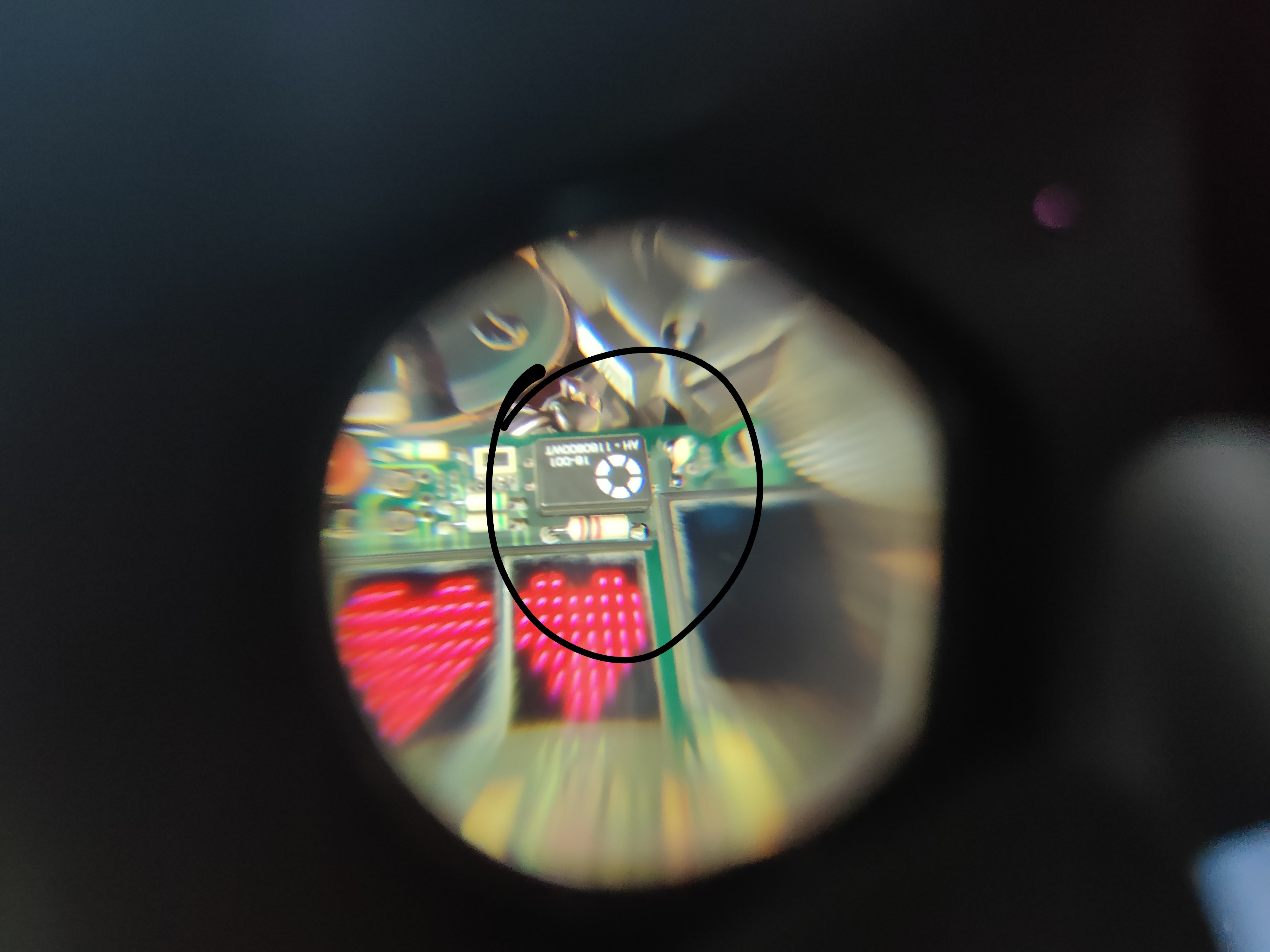

Source from RaiN274
Pimax XR vs Vive Pro 2
The VP2 being less clear than the g2 makes sense as to obtain 117 wide FoV it has to create a warped image or cropping vertical FoV. The Square panels should create a FoV more on par with g2 with vertical and Horizintal FoV values being close to the same. Where as iirc the vertical FoV on the VP2 is around 20 degrees less.
Thats not xr vs vive pro 2
thats Desktop Reference Picture vs Pimax xr , please correct/edit that so people dont get confused
I did before your reply lol

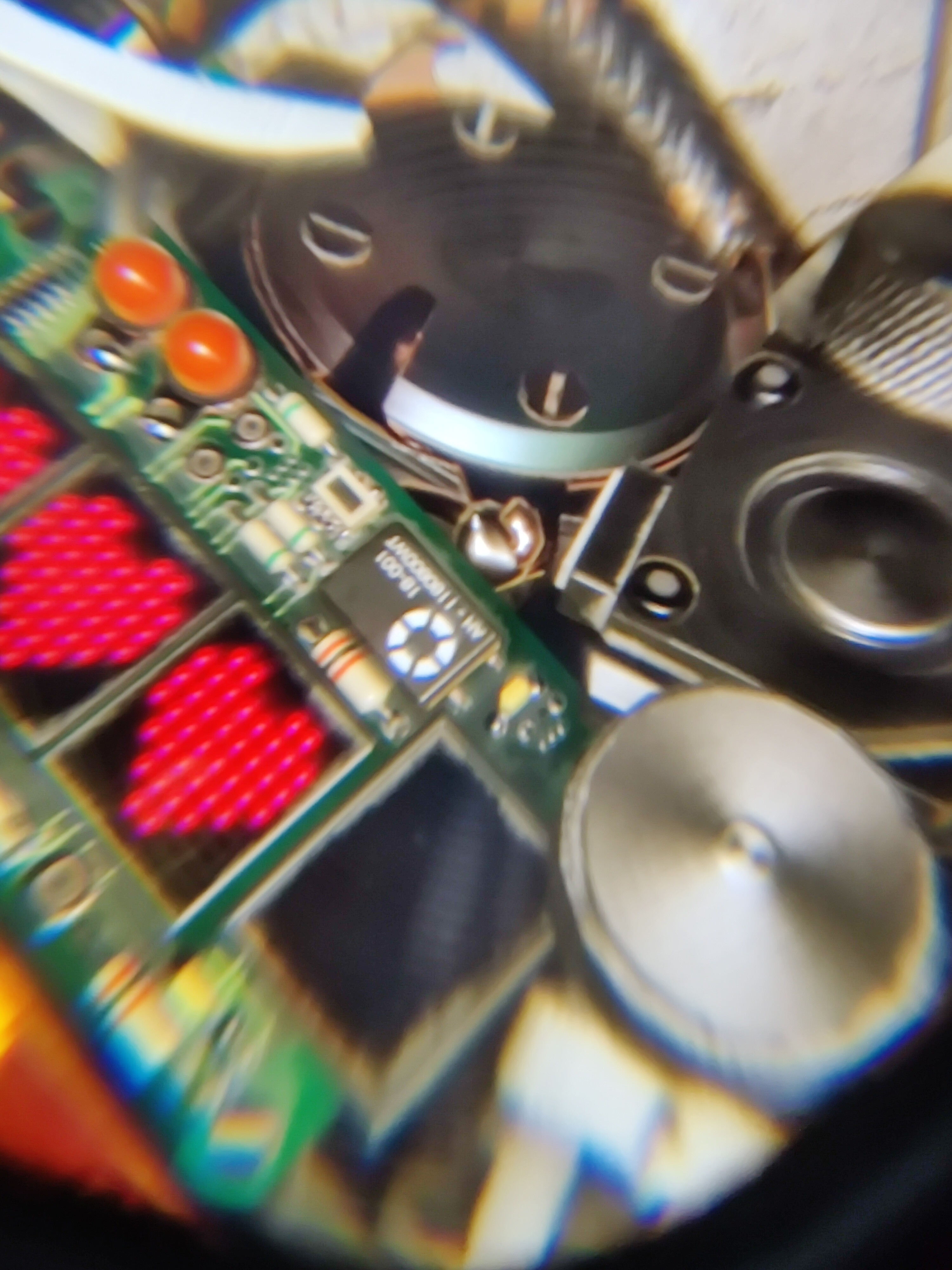

Wich graphic card do you have?When i select something less then ultra in the vive console then the vive pro 2 becomes blurry… I even have it now on ultra on 74% sampling in steam vr and it still looks good…The G2 is sharper… But the vive pro 2 is not bad at all…
I only race as well (AC). Great job on using brake markers as a reference point for measure. If you’re racing to win, the depth in clarity is hugely important. Being able to pick up your reference points earlier with better clarity is worth more than a fov increase. When I went from a 5k+ to a G2, I was instantly more consistent lap over lap and able to reduce the lap to lap delta by .150 just by having better depth and clarity.

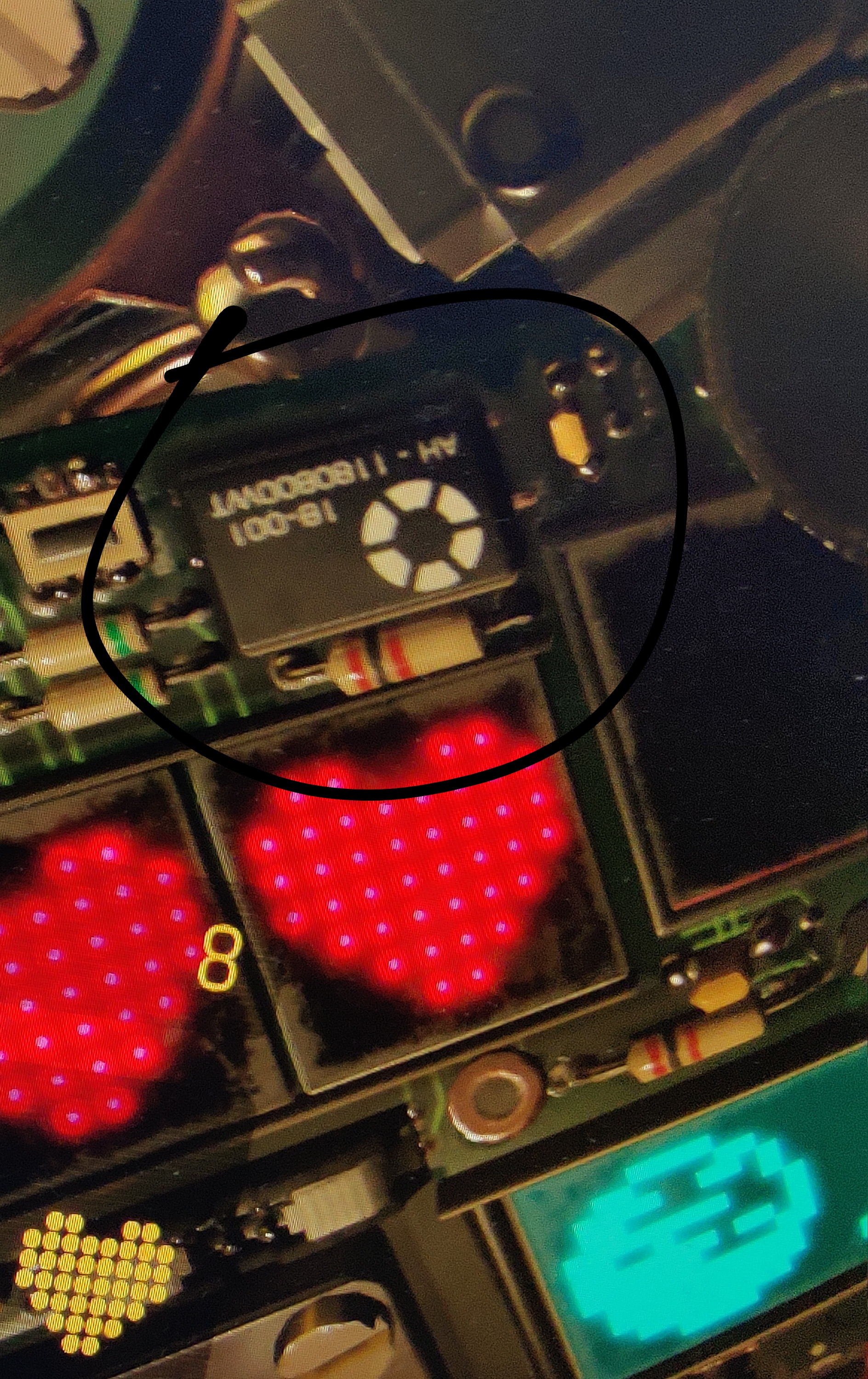

i just tested it, i can read it on the left glove on the vive pro 2,with the settings on ultra in the vive console and 74% sampling in steam…
In real life it looks better,i cant focus good with my mobile camera… sorry for that…
Okay you are right. That’s the Vive pro 2 :slightly_smiling_face:
Note: there is no chromatic aberration in the hmd itself , its due to the lense of the camera so it’s even better in real life
That’s at 4096x4096 per eye (150%ss) (rtx 3090 )
The G2 is a a bit sharper but Vive pro 2 isn’t that bad either :slightly_smiling_face:
