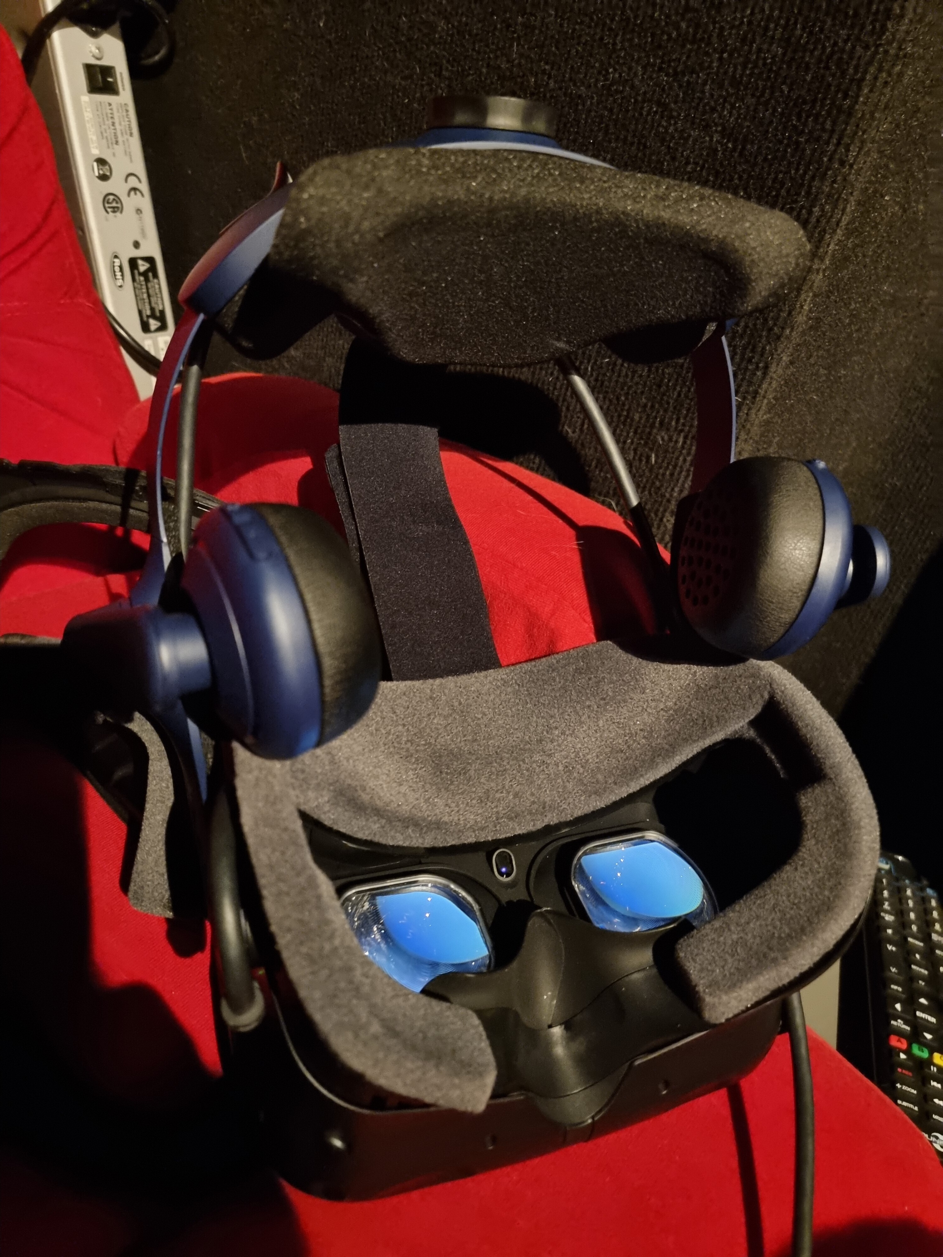

I’ve also received my Vive Pro 2 today and played around with it for 2 hours or so.
Since I still didn’t receive my RTX 3080, I had to test it with my RX 580 4G. I could not set the resolution beyond “High - 3672x1836 90hz”. Could be because of my old GPU (although it is DP 1.4), so I’m not worried about that for now.
I put on my old OG Vive thin face pads. FOV was better than expected (at least after this mod). I can barely see the top border and the bottom one I can notice, but only really bothers me a little when I look down. So vertical FOV is fine for me. Horizontal is a little bit smaller than Pimax 5K+ on small FOV, but definitely bigger than potato.

Whats your ipd though? How much fov you can see in ROV Steamvr environment? As an experiment can you remove the thin foam and get as close as posible to the lenses, does it get any better?
Did you try any hmd that have good sweetspot for you? (eg index or q2)
I’m actually not sure what my IPD is, but a setting around 64 or so seems best to me.
I also don’t have a measurement for FOV right now, just the comparison to the 5K+ (I did some side by side comparisons)
I did try removing the foam all together and it improves the FOV a bit more, but doesn’t solve the blur issues at all.
