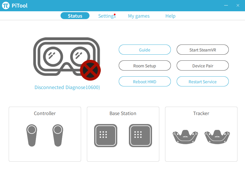

done successfully, but…now the device is blinking green, PiTools says 10600 (DP disconnected?)
Also, I cannot turn off the device by pressing and holding the power button.
I have tried several times to turn off and on the PC, disconnect USB, disconnect DP, change DP port, always without success. The device is recognized (windows recognizes the volume button), but the error persists.
I also tried to re-flash the firmware via DFU.EXE (successfully) and via DfuSeCommand.exe (always successfully).
immagine
What can I try? Who can I mention of the support team?
EDIT: also tried to completly reinstall PiTools, removing all related folder under AppData… no way… :frowning:
