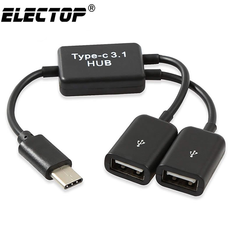

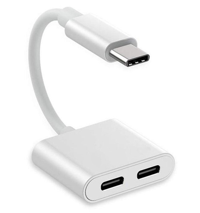

mhm… maybe i’m thinking too simple but if it’s not an bandwith issue (what i guess not when other HMD offer two ports and pimax’s statement that there was simply not enough space) a simple usb-c hub would solve the issue?
e.g. www.amazon.com/dp/B073JSV4DF or in black www.amazon.com/dp/B017H9CF1S
That might be a little bulky to affix to the headset?

yeah, a Y cable more like OTG hubs would be even nicer/compact, but only found ones with USB-A ports on quick search so far:
You wouldnt need this with 8kx > 2port-hub > port1: eye + port2: hand
The problem with that is the design of the headset uses the bottom handtracker USB c port. no way to attach the splitter without a pass through port on the handtracker.

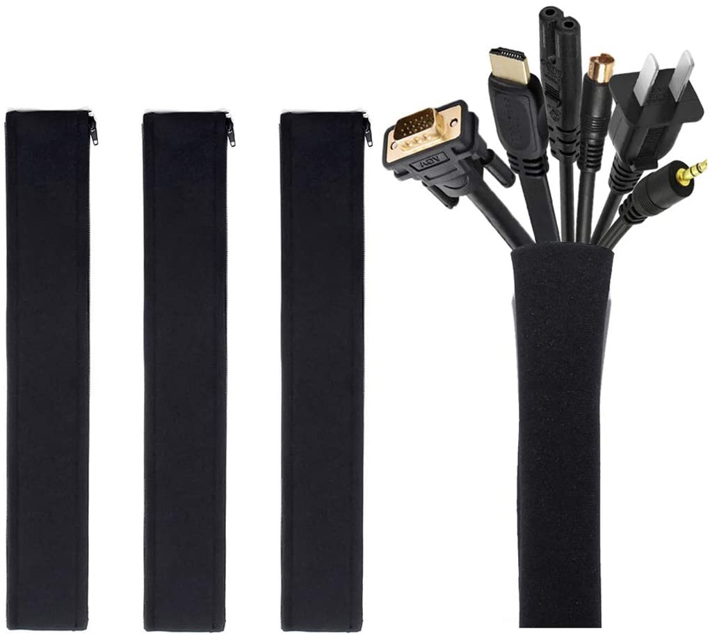

I think this kind of cable sleeveing will be good with a main cable and an usb-c cable for the eye tracking units except that it will make cables much stiffer.
My computer is on the other side of the room, having to run a whole nother cable to it is going to increase the weight of the cable substantially and is really not an adequate solution for such an expensive headset.

That’s what I use for my extension cables… :slightly_smiling_face:
