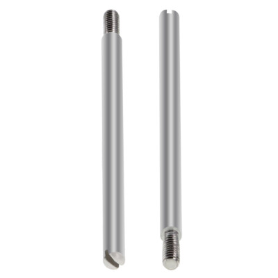

maybe here?
threaded axle
shoulder axis / screw
screws
Shoulder screws/bolts do seem to be a lot closer to what I am looking for. However, it seems I do not know how to specify that I want the screw head to be the same diameter as the shaft?

EDIT: This is what they look like:
“Strap link screws” or “Screw tube” or “screw in lug bars” or “screw tube bar rod”
Here an assortment:
https://www.amazon.co.uk/Assorted-Screw-Watches-Connect-Silver/dp/B07R5C3R42
A few others:
Thank you. I may buy some of those assortments. Seems they are indeed wristwatch screws. That helps.

Anyway, seems I missed these. David Kaufman from HacDC pointed out McMaster-Carr, so I decided to do another look (mostly out of despair).

Admittedly, I am not good at ‘guess the magic word’ puzzles. Apparently the keyword was “headless”, for headless shoulder screw.
