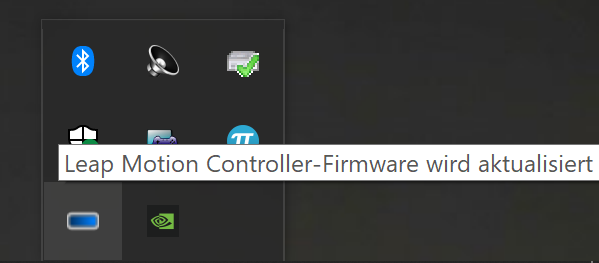

@SweViver WARNING:
Don’t connect an old LeapMotion controller to one of the external ports of a 5K+, 5K XR, 8K and 8K+. The LeapMotion software will think that you attached an UltraHaptics Pimax Module and try to automatically overwrite the firmware of the LeapMotion Controller (moving blue Leap Motion indicator instead of the normal green one) never coming to an end. It of course fails to update the firmware and no harm is done but you can get pretty nervous that you might just have bricked your LeapMotion Controller.
“wird aktualisiert” in German means “is being updated”.

Hmm it didn’t try to flash fw on my old leap motion, but I have unchecked “automatically install updates” in the settings menu

Wow thats good to know, thanks Alex! I actually dont have any of the old LeapMotion modules (except the ones made for Pimax), but it sounds like its important to prevent auto-update of FW before connecting to Pimax.

Ahh, I see. Better uncheck that option. Sorry if I knew that, I would have warned you… :slight_smile:
