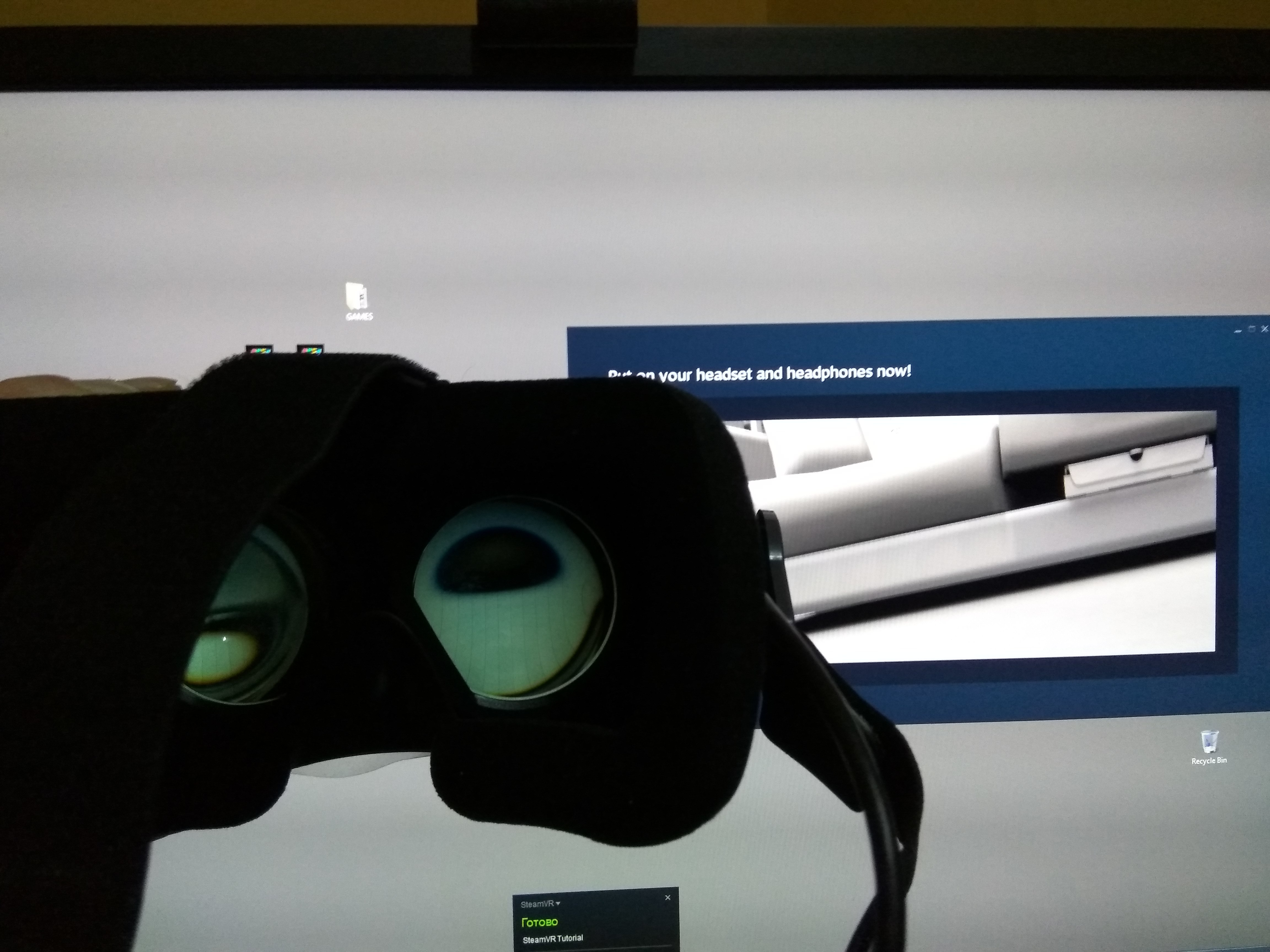

Hi, i have noticeable screen incline on left side. Problem presents in games and in steamvr calibrating room demo. Can i recalibrate gyros or its hardware issue of my HDM ? If it’s dont’have solution i’ll return my product to gearbest.
i have also problems with steamvr hope they fix it …if they dont i will also send the product back to gearbest
Room calibration was done correctly with the VR headset laying flat on your desk and facing the monitor?
Nah, it look incline to left. I´v been do calibration in Steam Vr
many times. In games the same - you hit center button and it centered but keep incline to left.
EDIT. I did calibration using my cellphone’s gyroscope for showing if surface is flat too. But no luck. Everytime is keep incline to left
