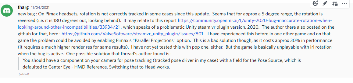

GreenHell VR also has the 180 unity rotation bug

Nobody is fine with the 180 bug. We are already all asking them to fix it you are preaching to the choir here. It has been asked / reported here and on github and on unity forums and discords and on many games. I don’t know why you seem to think you are alone. Here I think everyone agrees. Thanks for helping in the fight you are doing a great job. If you want to help me convince the Population One devs that’d be great too. Sure Pimax themselves haven’t guaranteed anything, but they are aware, it is in their interest for it to be fixed, but there is possibly a limited amount they can do. IMO it is reasonable to assume that they are doing all they can to see that it is fixed.

on their discord ( POPULATION: ONE ) :
PM to their devs (theoretically, according to a pinned msg) on discord :
Their support system that they ignore so far. Feel free to refer to my ticket if you start a new one :
https://support.bigboxvr.com/hc/en-us/requests/new
My ticket (3085) has the same text basically as my discord msg.
damn 1 year ago…,i will make a post on steam as there isnt one and report a ticket,they dont care tho.

There exists MelonLoader which allows for mods to unity games. KoochyRat and I had worked together on a mod that fixed the culling issue eliminating need for PP in games like Boneworks. I’m sure there’s a way to fix the 180 rotation bug with a mod too. Just need the code sample.
yep thats what i was thinking,and that culling mod still works i have it in boneworks very good job.
