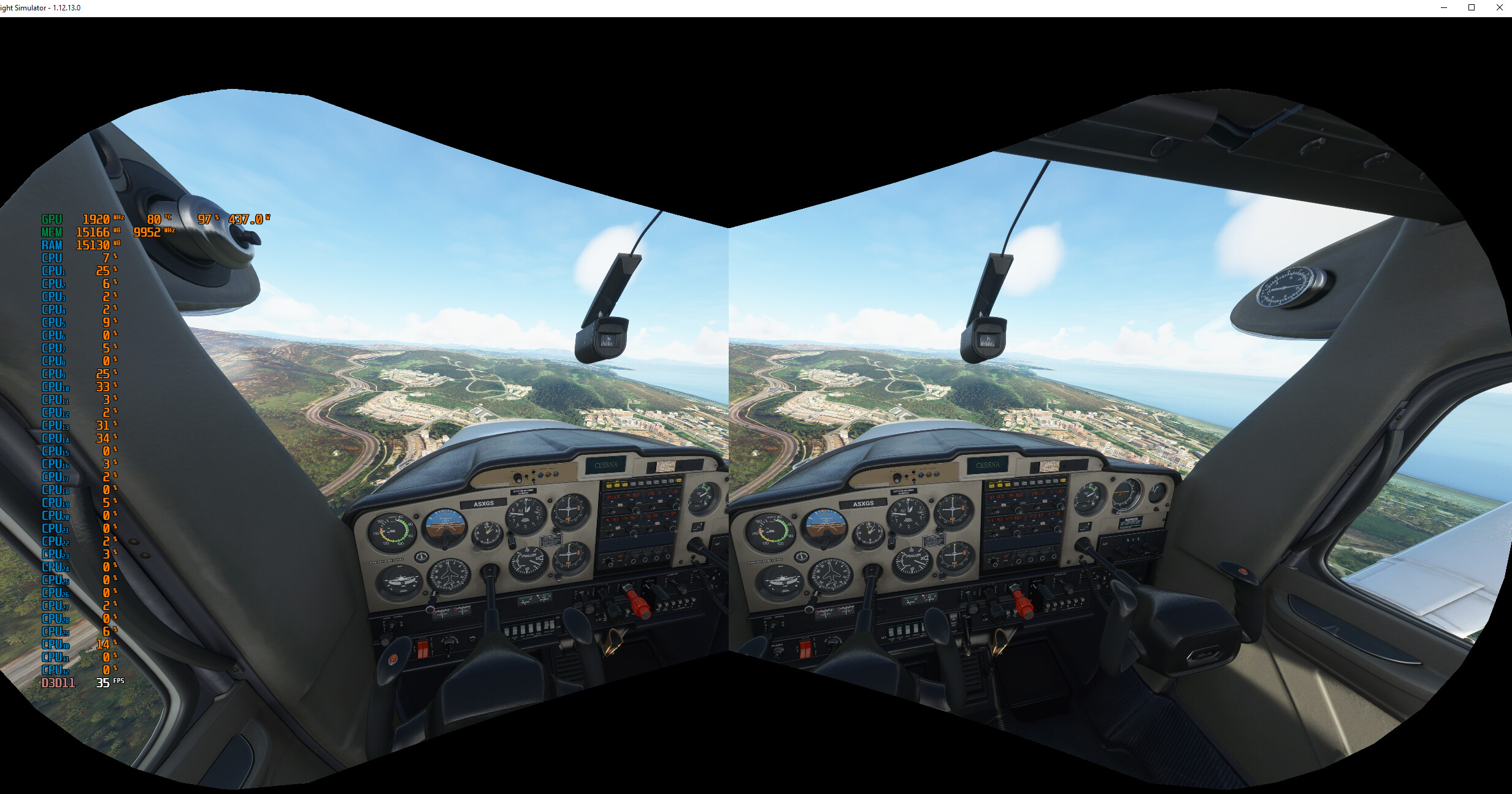

managed to do it, and disable theatre mode, but still stuck with the image off to one side. Very frustrating!

I had that issue the first 2 or 3 launches. Then it suddenly got corrected. If I remember it right, I did a PiTool room setup in between. And also did all changes I mentioned earlier. Suddenly that problem was gone. It really makes no sense. Ive been trying to replicate the issue again but it never happens anymore.

But that wont solve the incorrect render of right eye plus the crop of left eye. I have still no idea how that issue got solved by itself.
Did you try recenter the image with Space? Then restart the sim.
Just a reminder - overclock the CPU and disable HyperThreading.
I can’t get the Windows Store version to work either. I get the two square images shifted to the right. Tried all of your settings above :frowning:
