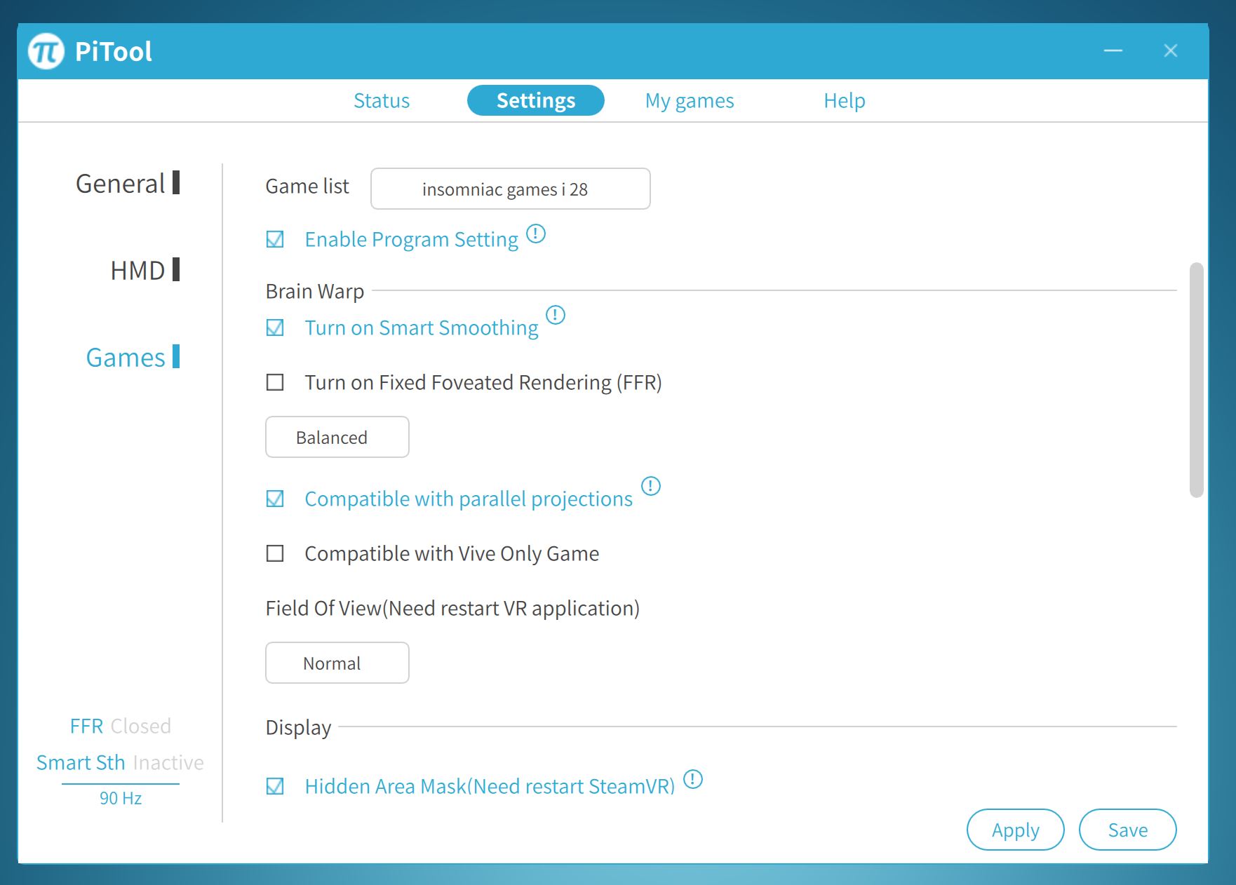

Here are the settings I’m using. The only issue I’ve had is the grip settings on the Index controllers. My hands will constantly grip the ground or my own legs with the slightest touch of the controller. I keep my hands relaxed and I’m still able to play it, but it would be so much better if we could set controller bindings within PiTool, specifically when running Oculus games and we don’t have access to SteamVR.

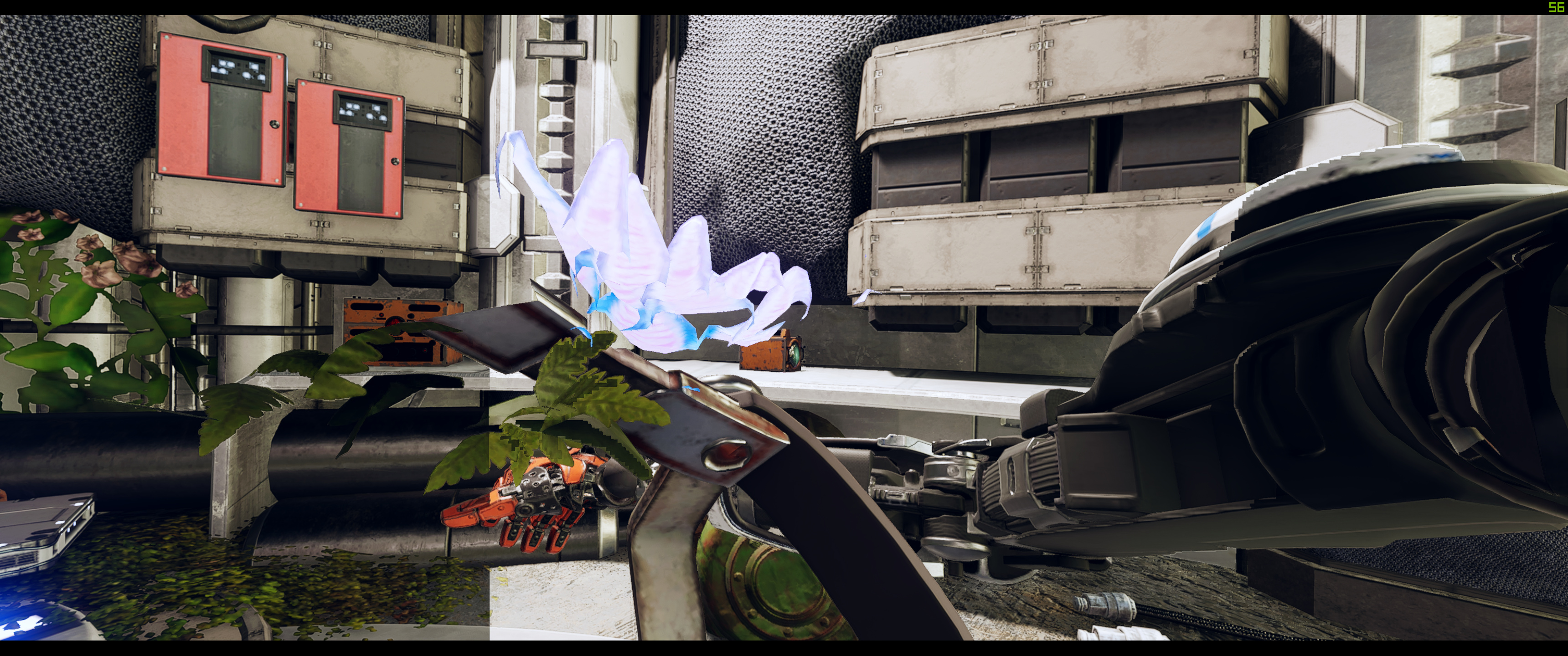

If you look closely at the Picture you can see what the Right eye sees in those cases, its not a shadow line, its where the Image starts getting a different lighting then the rest, the left is all darker, like the dark 1/3 here.
This is a much better description of what I’m experiencing…
I guess the lighting/shadow is changed In those cases, from a dev point typical afaik, and what ever they do it goes wrong at that point For VR @ the pimax - RTX and that would not be an issue ( for sure some others would appear;-) ).

I just played the game for the first time today using an 8k , when I tried it first I got the same as you ,different shading in each eye!
but using Razorub’s settings and PP on fixed it for me , game runs really well even with PP on.

So I tried it, it works very well setup like that and the wierd lighting/shadow effect on the right lense is resolved. I guess it runs a bit slower wit PP but very enjoyable (dont have an fps counter in occulus store games) - besides the early days, this game really starts to pull you in this an Asgards wrath are really worth it - glad that the PiMax runs does titels it would really be a miss not getting into them. I went something like 6.5 Hours in just 2 evenings - old mans record i guess ;-).
I have a ca. 50% Black Shadow in the right Eye with PP and large FoV.
With the normal FoV not.
