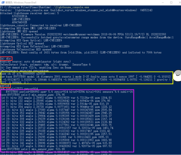

You may have already tried this, but if not, in \program files\pimax\runtime is lighthouse_console.exe, run this so it looks like this :
You should see 1 of the lines displaying LHR (something or other) EE9 if your lighthouses are being detected correctly, mine wasn’t.
So, like in the image, enter the command “dis” without the quotes. Try it a few times, i had to. My LH was detected then, it’s been ok since.
