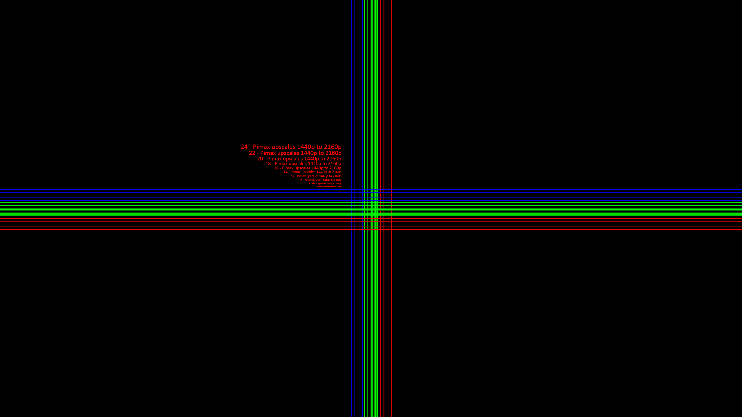

Try this one
Uploaded by one of the members.
There is also @neelrocker’s simulated oculus metthod.
Just tried this image, and I defiantly need lenses closer together (smaller IPD than 60) for a nice clear image.
You can read my post https://community.openmr.ai/t/clarifying-near-ipd-x-distant-ipd-confusion/14809 why it is not possible to use this method (clear image in both eyes) for correct IPD setting.
Then you can read my other post https://community.openmr.ai/t/pimax-native-projection-and-pre-lens-warp-transformation/15775 about how static image is rendered and why it is not suitable for IPD setting.
Not using it for IPD settings, I am using it to get the image directly in front of me in focus, and I cant, as the lenses need to go closer together and they do not.
I’m using Pitool 109 and that jpg doesn’t work for me, nothing is displayed. Anyone else got it working with this Pitool version and if so how?
Yes its working, double check the filename it must be exactly the same.
Then restart the pi-something… everything. Or reboot the Pc and so on.
Make sure it is named “pimax_default.jpg”
And its in " C:\Program Files\Pimax\Runtime\resource"
Restart PiServiceLauncher.exe service.
Well, I thought you were trying to set up an IPD. Technically, it is possible to set the lenses on the headset in such a way that you will see the cross clearly, but the outcome of this exercise is basically useless, because it will set a wrong IPD and therefore distort the projected angular verity of both eyes, possibly leading to other issues.
I am just trying to get the image in front of me in focus, and to do so I need the lenses to go closer together. try setting you IPD as high as it will go , this is how I see the image at IPD 60.
What is your real IPD?
