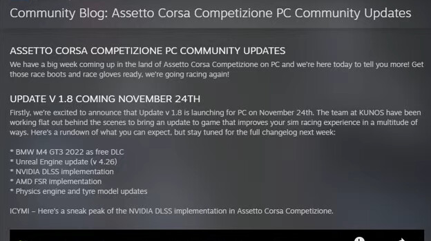

DLSS particularly for VR will be amazing for ACC!

'still can’t get 90 Hz working on the 8KX… too bad because it would have been awesome on ACC…
