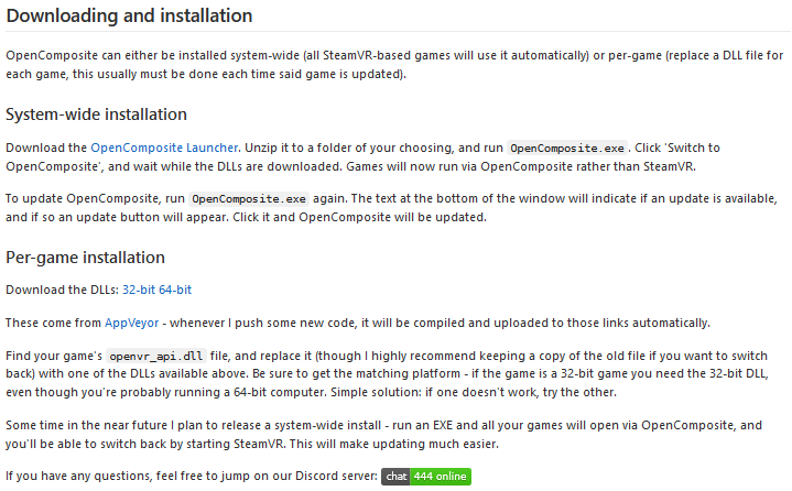

Please read more about .ini storage locations and options.
This page was a big help to me and I encourage you to read it.
Install necessary tools and replace DLLs
OpenXRToolkitv1.1.4+PimaxXRv0.2.4+OpenComposite+DLL

Does OpenComposite really need to be installed, since this seems to be the system-wide installation?
Shouldn’t it be sufficient, to install the corresponding DLL only, if I’d like to use it for ETS2 and ATS only?
I don’t know if that is necessary as I use toolkit for multiple titles.
Okay - it generally works without having installed the OpenComposite system-wide.
But the image is turned upside-down.
I suppose this has to do with the settings in the ini-file - but I cannot find any opencomposite.ini anywhere…
Normally, it should be located next to the DLL in the game directory
… but there isn’t any…
Where should it be located?
Or from where may I download one in order to copy it next to the DLL? Cannot find any on GitLab, either, so far - or I am just blind
