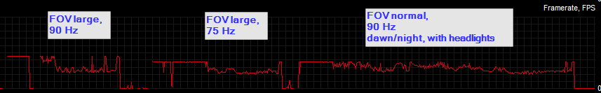

Did some further trials with ATS, with a little sobering effect.
First, LargeFOV & 90 Hz, FSR with Sharp10%
=> FPS dropped significantly down to “unplayable” 40-50/55 FPS in town (Bellingham).
Unplayable less in terms of FPS - normally, I should be used to play with such low FPS for years :joy: - but the image seemed to be a bit more blurry compared to my first trial this morning.
Second, LargeFOV & 75 Hz, FSR with Sharp20%
=> Still FPS in the same area, 40-50/55, not really an improvement noticeable. Image quality got a bit better.
Last, back to NormalFOV & 75 Hz, FSR with Sharp20%
=> Close to my first experiences this morning, 70-75 FPS, with a couple of drops down to 60/65
What made the whole thing a little bit sobering, is that I turned on FPS display and finally noticed directly the large impact of headlights on FPS: It was dawn, so had to turn on headlights
=> w/o headlights: 65-75 FPS
=> with headlights on: 45/50-65 FPS, even on plain highway.
Didn’t know so far, how large this impact was… holy moly… :open_mouth:
Seems, as if I still have to tweak around with it / might even be, the implemented FSR/sharpening mode make things worse…? … although I made very good experiences with fholgers FSR mod in ATS/ETS2.

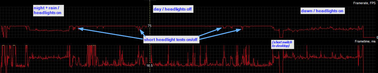

I made a longer drive from Seattle to Grangeville now - and probably it is, because I never had almost stable 75 FPS before ever - but the FPS drop when switching on headlights, is remarkable. I feel it instantly, and I get “confirmation” by MSI Afterburner:
It stays playable, of course; I’ve played so and worse for the last years :wink: and was defending this always :joy:
And I get back used to it after half a minute - but holy moly - I never thought having stable 75 FPS makes such a large difference.

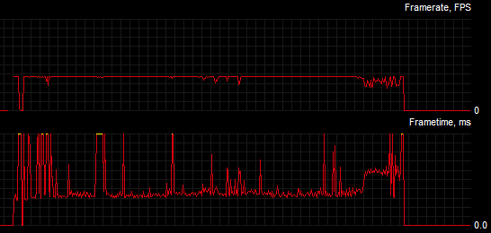

Could you perhaps upload a similar FPS graph from one of your next sessions, please? :slight_smile: Would be nice to see the comparison directly.
Did you use anything in the OpenXR and PimaxXR companions? Changed any settings there, etc.?

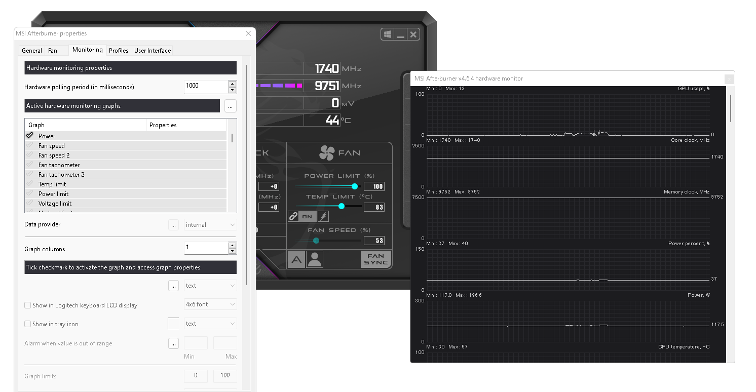

I installed MSI AfterBurner and tried to configure it. It will take some time to investigate, as the item regarding frame rate does not appear.
Curiously, it consistently dropped to 50 FPS in today’s play.
90 FPS on the menu and 50 FPS on the drive.
Smoothness felt the same as yesterday.
The monitor is set at 60Hz, VR at 90Hz, which I began to suspect was affecting the measured results.
I don’t know what is happening but will observe for a while.
I did a longer session in Montana yesterday. During daytime, it was generally ok and close to stable 75 FPS, but more drops in cities and settlements as two three days ago in Washington and Idaho.
Plus the known drops as soon as I switch on headlights.
So once again, with Montana as with Wyoming, Spain or Austria Rework, the new DLC/maps are more demanding than the old ones. I think, if I would have been in Oregon, Washington, Nevada or Arizona, NM perhaps as well, I would have had 99,99% stable 75 FPS, except at night. So, it’s still a bit of a race, we and VR performance against SCS and graphics improvements :smiley:

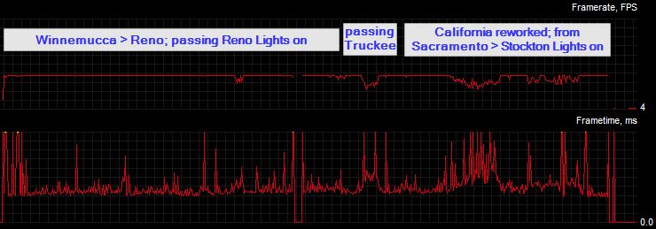

I did some further trials with ATS @OpenXR:
Settings:
SS ~110% (4.000 x 3.333)
FSR 85% (3400 x 2.834)
Sharpening 70%
FFR custom
  • inner ring 70%: 1x
  • middle ring 85%: 1/2
  • outer ring: 1/16
As you can see from the graphs, it is very well playable on the “old” maps, even with lights on => no difference, almost stable 75 FPS.
As soon as I get to reworked areas such as the route from Truckee just before Stockton, at least headlights have a more or less significant impact down to ~45-50 FPS at worse. Delivery in old Stockton itself was a bit stuttering as well, but not as bad as passing by Sacramento.
In total, I think those settings are playable very well - although I have to double check as soon as getting back to newer map DLC’s such as CO, ID, WY or MT…
