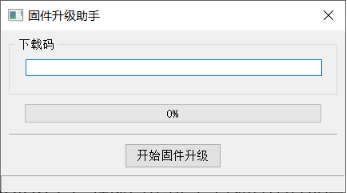

  1. Connect the Droolon to the computer (you can see a camera called Mobile VR on the device Manager)
  2. Open the UpdateFrimware. Exe
  1. In the network state, enter the download code: UI5Z6CZB
Be careful not to disconnect the device from the computer
  1. The following figure indicates that the update was successful.
  1. Disconnect the Droolon Pi1 from the computer and reconnect

anyone know what this means XD
it says, device not found. i’m getting the same.

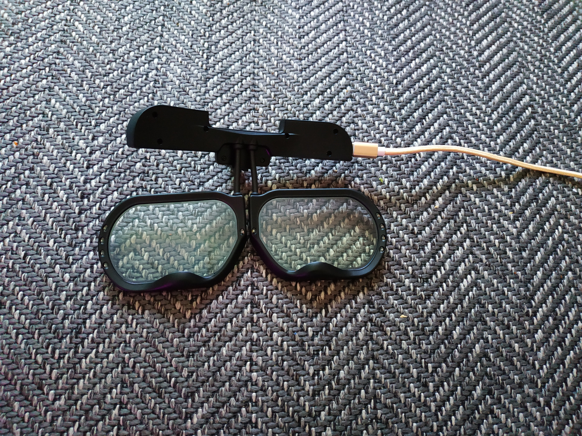

Hi @PimaxQuorra apart from the device not found. how exactly is this thing supposed to mount on the 8KX, there is physically no room for the USB connector since the top USB on the 8KX port has been closed of.
edit: the mounting issue is solved.
i can answer that one. the port on the side, you use the little cable that came with it to wrap aroubd under it to connect to lower usb.
no that is not the problem. the front usb plug on the module has no where to go because the top usb port has been closed off. that means the module physically can not fit on the headset because the module can not sit flush with the headset which again means the comfort kit won’t fit back on right.
oh jesus seriously…

Droolon Pi1 Webcam?
20202
Can u post a picture? Would be funny.
