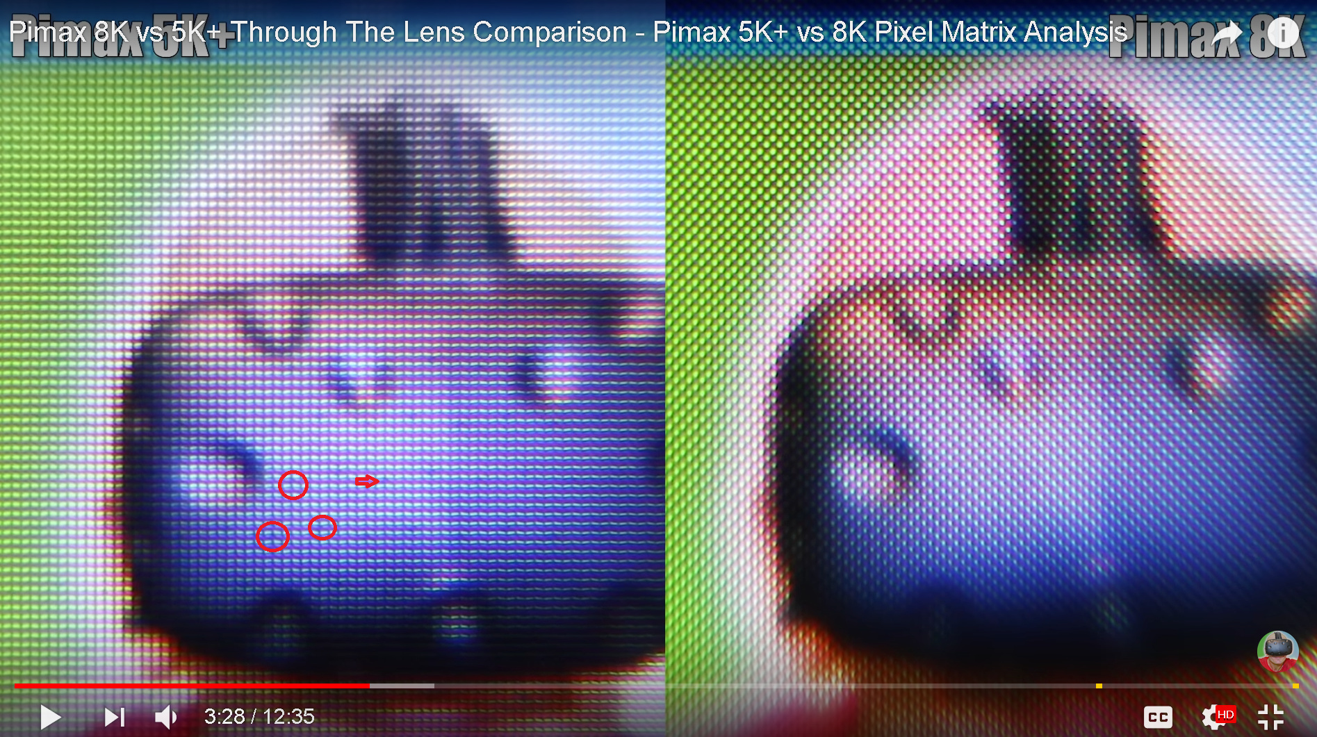

Your right it’s not mura because it’s uniform across the panel, I’ve look very closely and it’s a 2 dots dark space in a 5x5 pixel a part pattern. we can’t see them in Sebastien and voodoo captures because there too zoomed out. The image must be 100% focused to see them

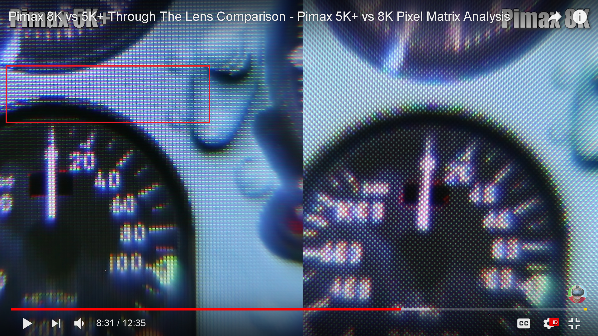

I have checked the close up shots from @SweViver comparison video and the “dark dots” form the regular “wave” pattern. They are 5 pixels apart and 1 pixel up and down. See the pic below (taken from text readability part).
The dark spot is always on vertical line which forms the matrix substrate and it looks like what actually suffers the most are the red (or possibly blue - hard to say here) subpixels. So it is hard to impossible to spot on pure green area.
