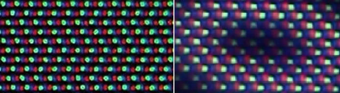

Take a look at this image comparisson ; left Pimax 4K (Xperia z5p) and right the pic from @some1, the green pixels looks the same size in both (maybe a little bit more bigger in 4K), only IMO; the screen layout is different; zigzag in 4K and diamond 8K, dots and squares… :sunglasses:
what happens is that the 4K do not have the same separation between the pixels in both dimensions (vertical and lateral) that can be seen as an error of perception at the beginning of using them, over time you can see that they are practically the same only 4K have a smaller measure in one dimension but higher in the other.
personally I like more the 8K, not having to see that zigzag pattern…
A user explained usually find the diagonal pixel layout in panels in some projectors
Good picture, @some1! The image
that @neal_white_iii has made from this picture explains to me why I saw the 8K SDE as I saw it, since it seemed to me to see only one corner, which would coincide with the space to the right and below the green subpixel.
