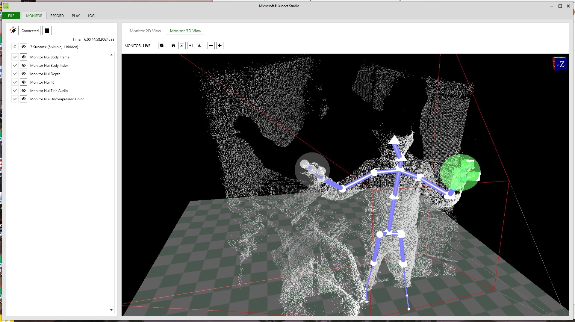

A 3D image of me from the Kinect One using Microsoft Kinect Studio (free from MS).
Body tracking is amazing. If this could be used with pimax we would really have something fun :slight_smile:
