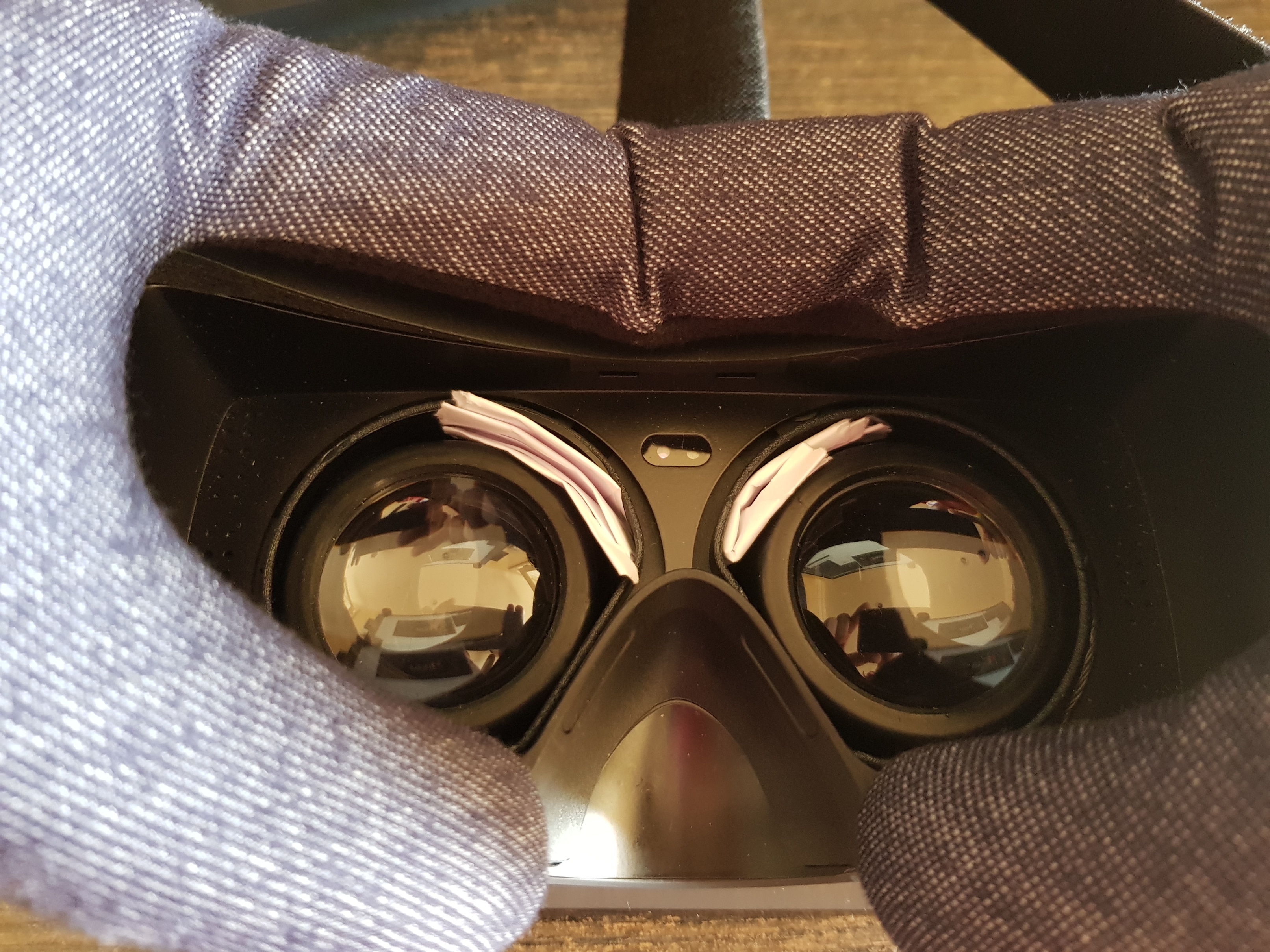

So I’ve just tried it, popped out the Pimax lenses and pressed in my Homido lenses:
My optimum IPD now went to 66 in Piplay (while I have 68 in reality). Maybe I should try to get the lenses even slightly further apart.
It does feel easier on the eyes already, but then again I’d probably need to try it for a bit longer time. Downside is, as you can imagine, that the FoV is getting quite a bit smaller.
