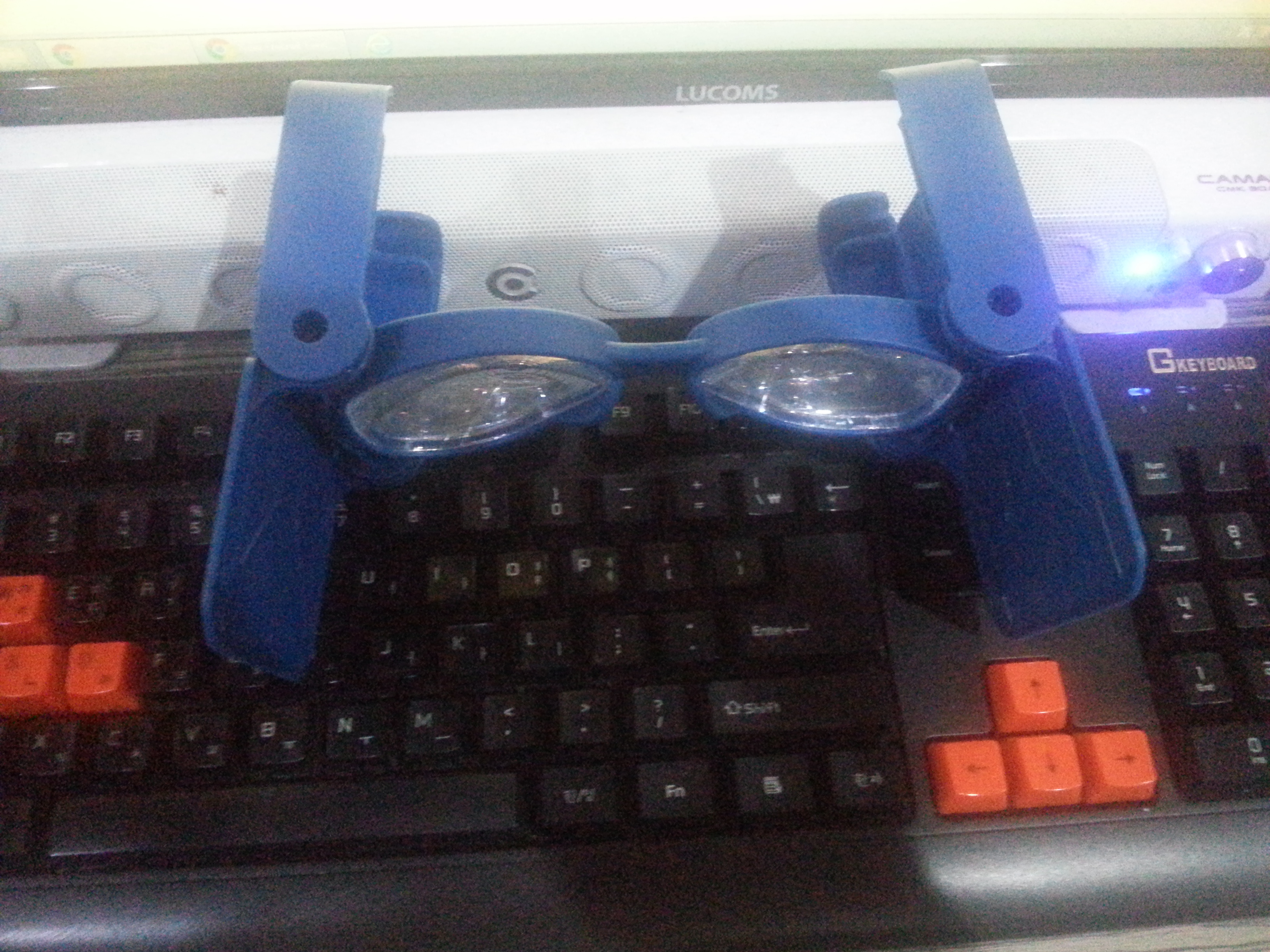

Quite a bit unfortunately with my Homido lenses as in the pic above. I think pimax FoV normally is about 90 degrees, with those lenses it gets down to about 65 degrees. However I think I’m going to use it like this for a while, it feels much better on the eyes, I feel less disoriented after using it and in general I have a clearer image.
So this definitely is caused by the lack of hardware IPD. I really hope pimax uses hardware IPD for their Pimax 8k @deletedpimaxrep1

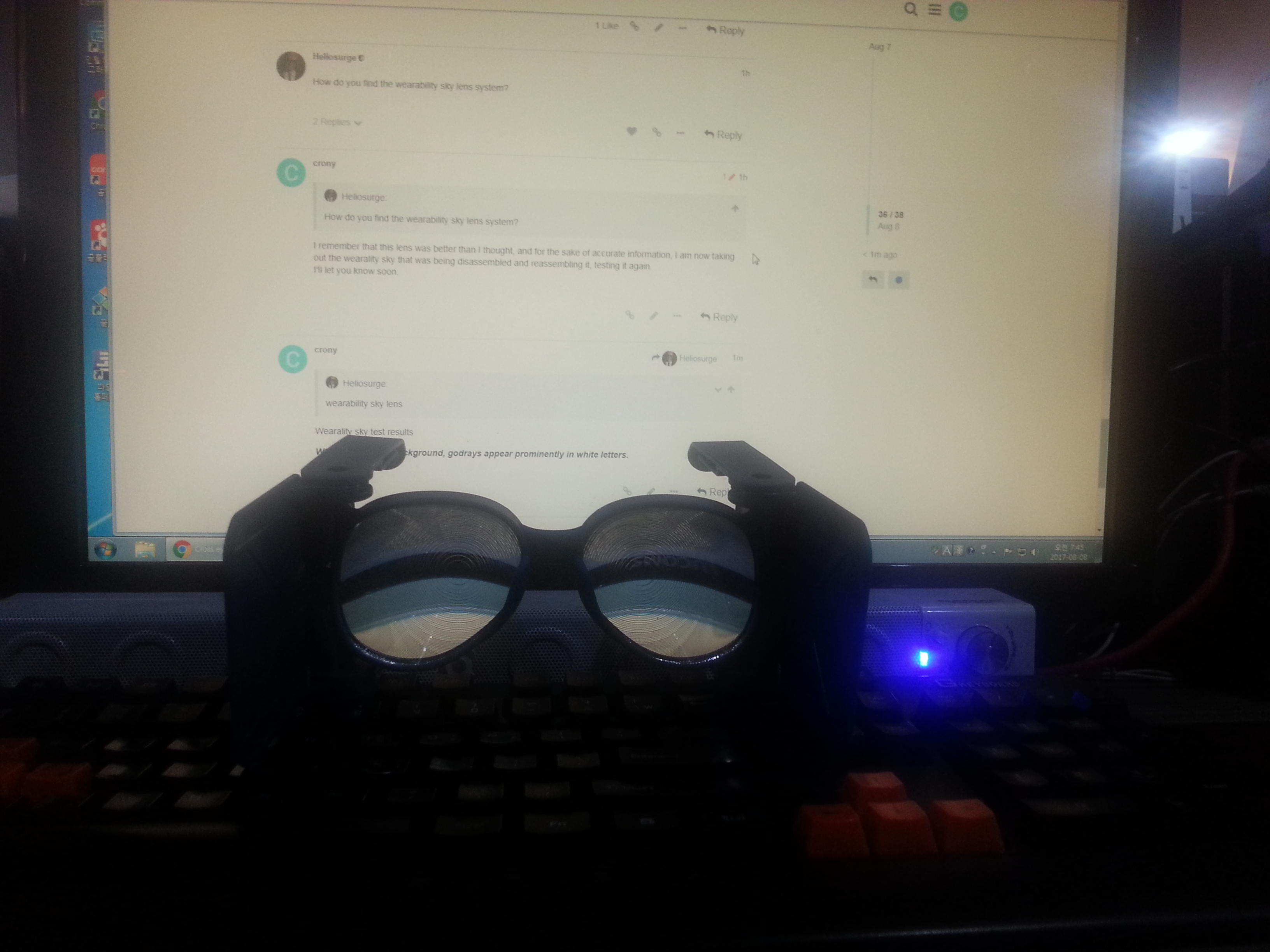

How do you find the wearability sky lens system?
I remember that this lens was better than I thought, and for the sake of accurate information, I am now taking out the wearality sky that was being disassembled and reassembling it, testing it again.
I’ll let you know soon.
Wearality sky test results
When it is a black background, godrays appear prominently in white letters.
