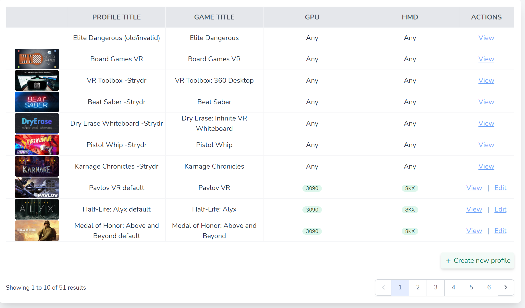

Here you can check whether there are profiles for you.
https://pimax-vr-experience.artarmin.com/login
I have created a lot of profiles for 8KX with RTX3090.
My name is “DEFAULT”
What kind of graphics card do you have?
Thanks a lot my graphic card is a RTX2080
You will only have the profiles available that have had the gpu set for ‘any’ or your rtx2080. So anything that just says “3090” or says “2080Ti”, without the “2080” selection will not show up for your system.
So, to put it bluntly, you can only use the profiles on the first page(and VRChat on the last page): the other profiles are locked to you.

I can’t check it. Its grey and not active. I saw that profile is for “any” and there is a list of HMDs and graphics cards. And 5k+ with 2080ti is in those lists. But that box is grey.
No, it is not possible. There is no relation between the GPU models in PE to indicate one may be higher or lower than another (and will never be).
