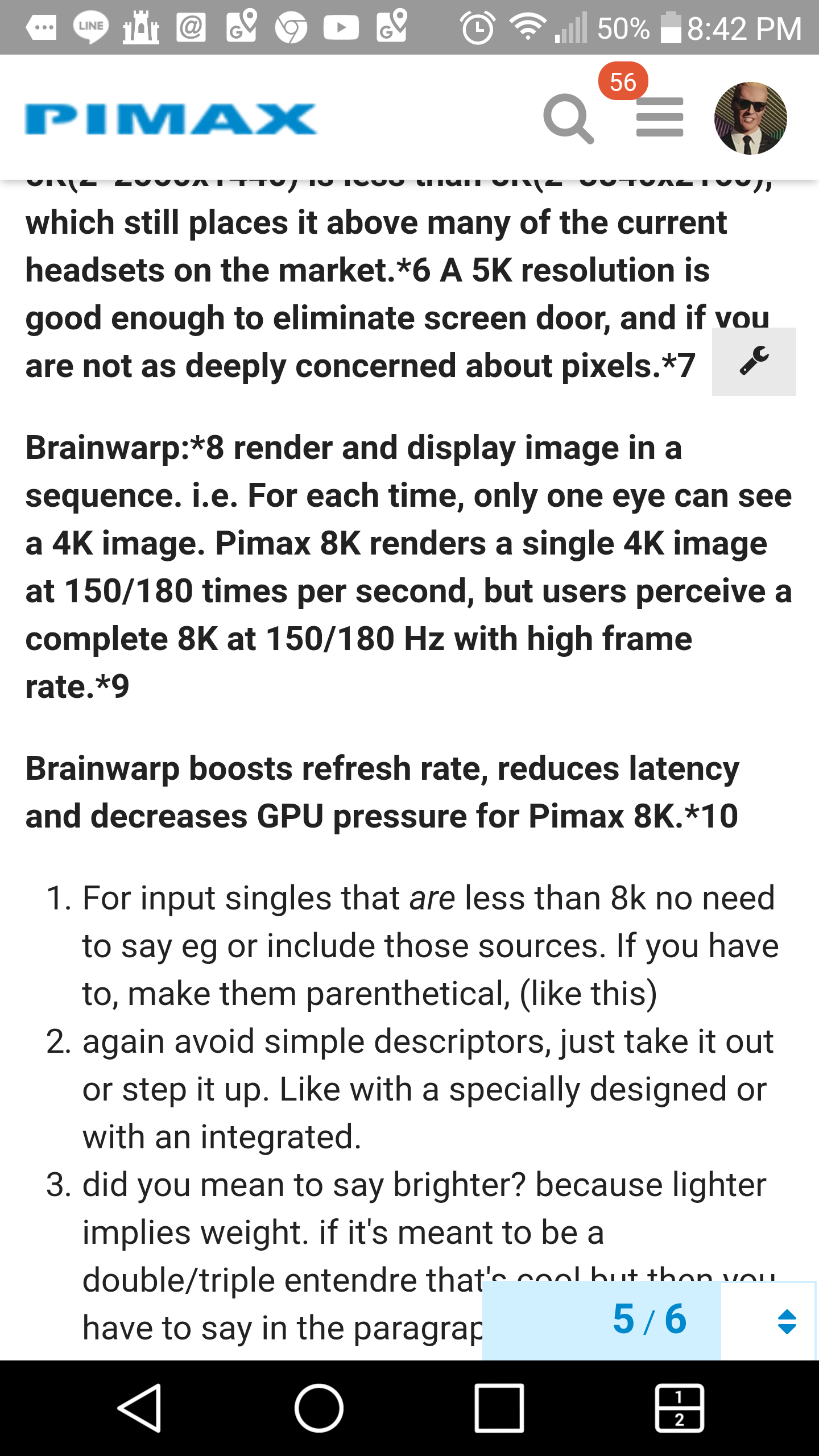

Brainwarp in a nutshell uses an optical trick.
From what is said above 1 panel fruns at 75 to 90 hz.
1 4k image is generated 150 to 180 times. 1 eye sees the image while the other is blind. This tricks the brain into perceiving 150 to 180 fps.

I understand that, but even if one eye is blind, is there other a NEW frame, a reprojected frame, or is it a copy of the other eye?
My concern is refresh rate of the physical display is arbitrary if the signal fed into it isnāt presenting new frames for each refresh cycle on the display. In simpler terms:
If you watch a 60 fps movie on a 120 hz display, the movie (without some smooth motion interpolation) is perceived at 60, because thereās no new frames to fill in every other frame on the tvās 120hz refresh rate. So between the fps signal to the display and the native display operating hz, the content is perceived as whatever is the lowest common denominator. Thatās why Iām hoping that pimax hopefully uses interpolation to add new fram3s to make 180 fps, and not simply double every frame with the same image because doubling every frame in 9p frames per second with the same image will still feel like 90.
The huge allure in whats advertised of 180hz is 180 frames per second
Does anyone know if they reproject frames to 180?.

The good news is a rep told me they do infact use a proprietary reprojection algorithm. The big question is whether itās 180 frames or not. I mean, I get that the image is left eye right eye sequentially, but if itās not left eye new frame right eye new frame itās just going to feel like 90hz. So hereās hoping we get some clarification. The GOOD new is what pimax has said officially, which is they RENDER 180 frames send them in sequence left eye right eye alternating at 90 times per eye. So yes thereās a chance each frame to each eye is a NEW image, which then would mean the effect of brainwarp would indeed feel like smoothness of 180 fps.
I know for a fact that games render the left eye and the right eye together, at once and that these belong together, so that they show the EXACT same image, just from a slightly different perspective.
I think the only way this makes sense then is that if Pimax doesnāt show the right eye like it got it from the game, but interpolates it. Because if it doesnāt, well then I agree with you that it wonāt make much difference at all.

I get all that. My concern was whether if the left eye gets the first page in a flip book animation, does the second page contain a copy of the first page for the right eye or does it contain the next image to move the animation. Looking over some of there material on the Kickstarter it appears they RENDER 180 images and disperse them in sequence left right left right. Iām okay with that, as I donāt care if itās a trick to fool my visual cortex if the motion just looks smoother, itās saving a tremendous amount of processing and bandwidth.
The game supplies 2 ācopiesā. However I THINK that their own renderer will do an interpolation on one of those 2. Otherwise I donāt think it would make much sense. In the flip book analogy to repeat 2 the same image indeed, thatās not going to make any difference.
Pimax doesnāt seem to want to explain though.
