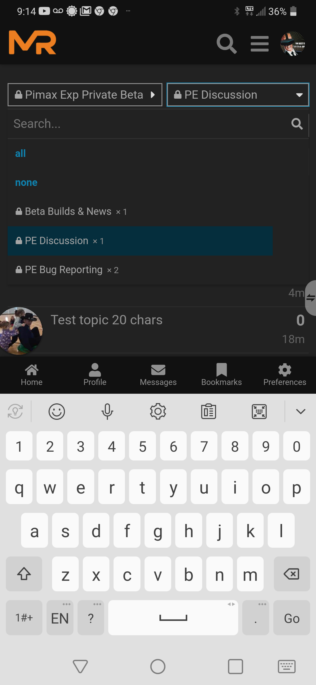

Not sure if bug or just being dissed. but it seems this is the only thread i can actually reply in. (also not able to create threads it looks like)
hmm thats strange :confused: . @Heliosurge could you please double check so users can create own topics in the category?
Try refreshing the page and or flush browser cache.
All settings verified you should be able to reply and create topics in bugs and duscussion
I will be away for a bit as need to go do a job. Wil check back later. If needed will try the omr test user

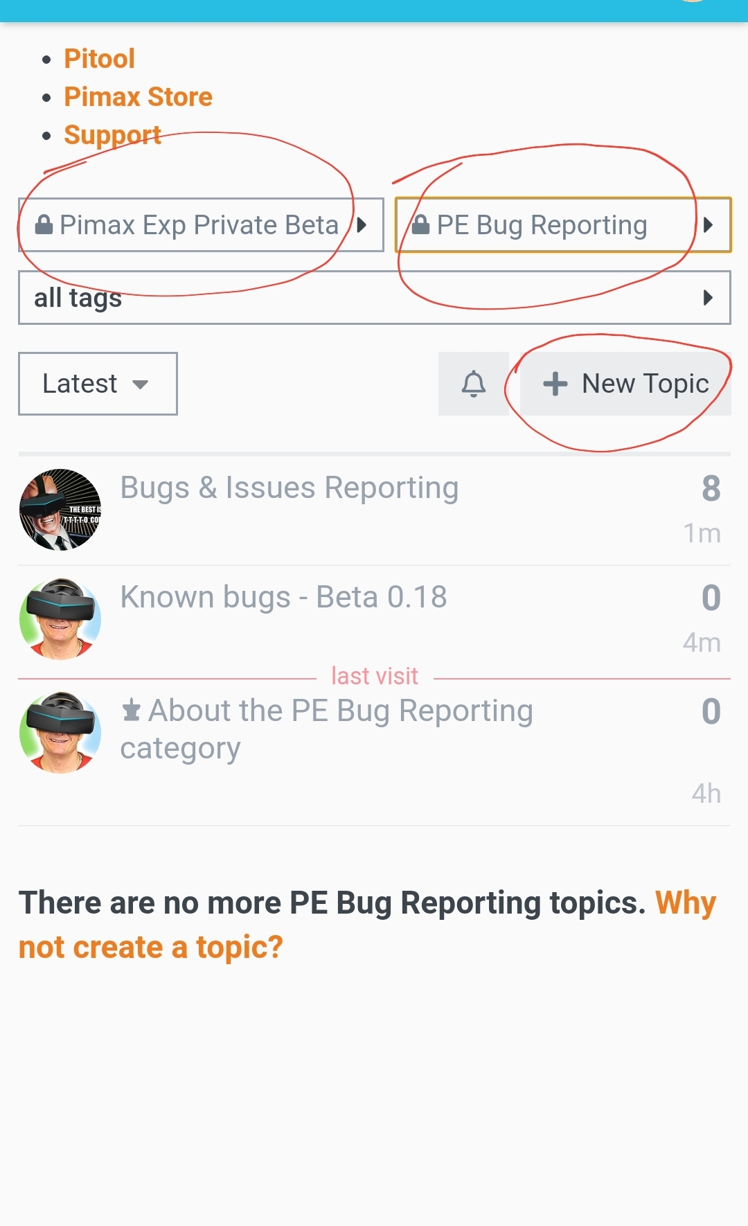

I can create topics and reply to threads in PE bug reporting. but not in pimax exp private beta
That is the main category. You can create and reply in Bugs and Discussion subs
Yeah it looks a bit confusing from start when the categories are so empty. I was also unsure if I really posted in correct category. But Im sure it will be easier to understand the categories when more posts are made.
Try this link
https://community.openmr.ai/t/test-topic-20-chars/30120?u=heliosurge

The first one listed is the Parent Category not postable in.
Pimax Experience Private Beta
You can post in
  • PE Discussion
  • Report Bugs
Try the link as that goes to PE Discussion.
InPumax Hardware you can’t post there. But you can in it’s Subs.
