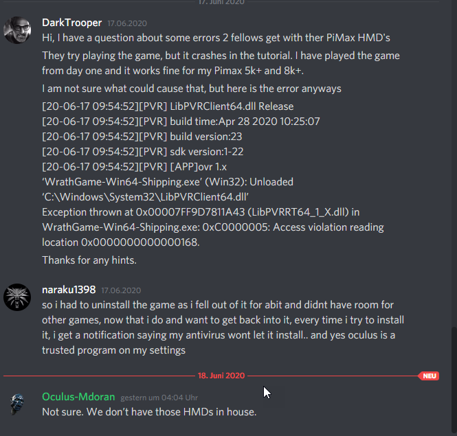

Managed to get some more info by attaching debugger at the time of crash:
[20-06-17 09:54:52][PVR] LibPVRClient64.dll Release
[20-06-17 09:54:52][PVR] build time:Apr 28 2020 10:25:07
[20-06-17 09:54:52][PVR] build version:23
[20-06-17 09:54:52][PVR] sdk version:1-22
[20-06-17 09:54:52][PVR] [APP]ovr 1.x
‘WrathGame-Win64-Shipping.exe’ (Win32): Unloaded ‘C:\Windows\System32\LibPVRClient64.dll’
Exception thrown at 0x00007FF9D7811A43 (LibPVRRT64_1_X.dll) in WrathGame-Win64-Shipping.exe: 0xC0000005: Access violation reading location 0x0000000000000168.
I don’t know how all this is supposed to work, but I doubt LibPVRClient64.dll should be reloaded (since it is usually only loaded and initialized once at application start). LibPVRRT64_1_X.dll then crashes, possibly due to LibPVRClient64 not being loaded anymore. Could also be the other way around, that LibPVRClient64 gets unloaded due to the error.
I should probably test the behavior in Revive and see if the same pattern repeats when that crashes. Man I wish I could play this game…

I asked in Discord, but nothing came from it…
