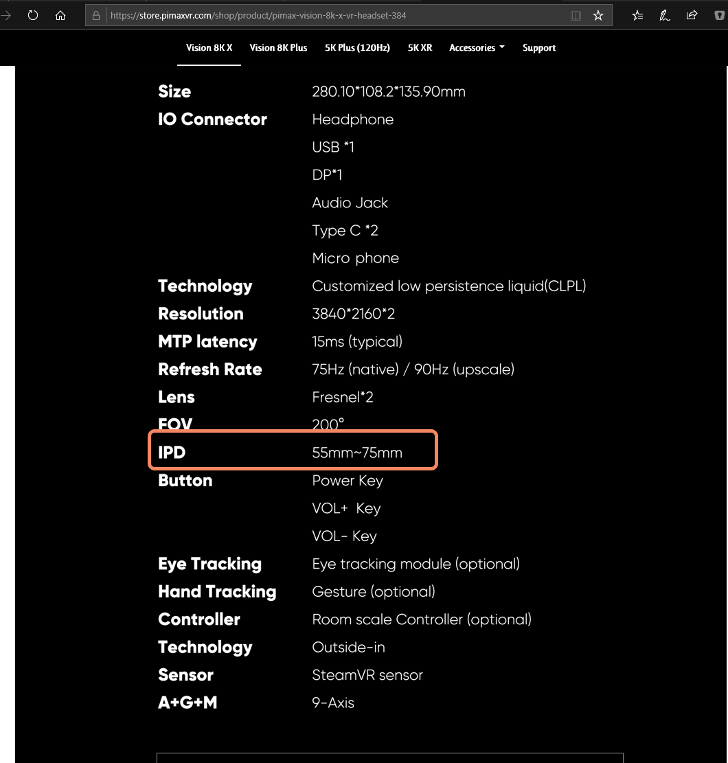

is the new 8k+/x vision the same ipd i.e the real value only being as low as 60?
I can’t find the information right now but I read somewhere that for the Vision models the IPD starts below 60.
Yes its approximately 60 to 71/72mm
You can also adjust the IPD +/- 10 in PiTool using the offset, like with the other Pimax models.

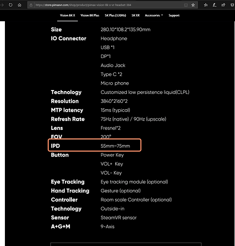

Might ask to check or update the site it shows 55 as is in 60 - 5 Software?
Would be good to add something like
60mm (55mm) - 70mm (75mm) (Software adjustable)

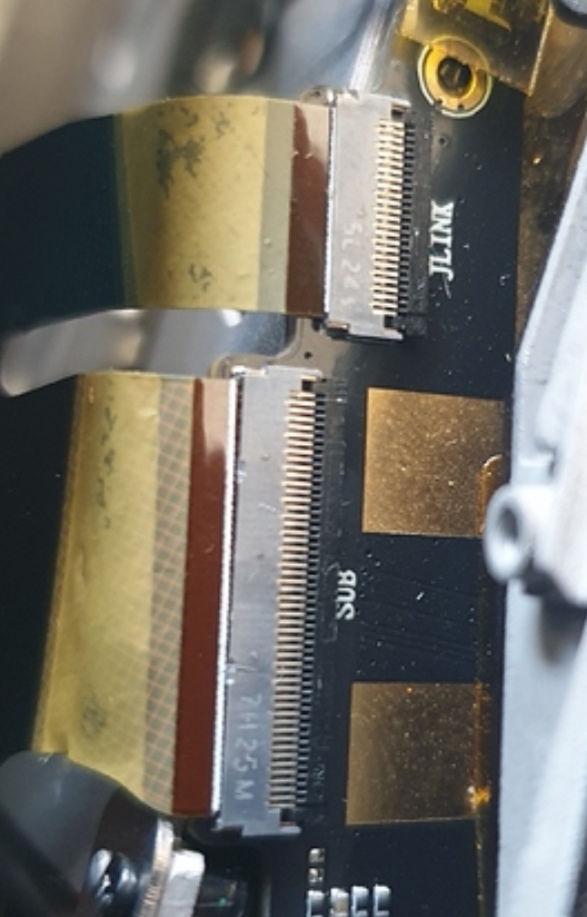

I cracked open the shell of my p8kX the other day, with that mod in mind, but balked at not spotting, nor feeling, any obvious tabs or levers on that first flex ribbon cable connector from the front cover (I assume it’s a ZIF jobbie…). Any advice on that, as well as subsequent matters, in case I muster the courage to have another go? :7
I was somewhat alarmed, btw, by how the unused smaller end segment of the cable was just dangling there, up against the sheet metal. :stuck_out_tongue:

Should be a quite obvious black lever at the back of the cable connector :thinking: what’s a ZIF jobbie?
I can support you as far as I can, but keep in mind I’m not really an expert on electronics. But I’m at least a bit familiar with small electronics and got the basic tools at home :blush:
Hmm… I saw no such lever - just the surface mount legs coming out in the back, but now that I know it’s there, I’ll have another look.
ZIF stands for “zero insertion force”, so simply a socket with a closing mechanism, like that lever I missed. :7
EDIT: Oh, and thanks, by the way! :slight_smile:
https://community.openmr.ai/t/pimax-5k-teardown-panel-info/17276
You can see the black lever in this teardown thread.

Not only do I see the lever; I also see a connector for the forked-off narrower cable terminus, which does not exist in my headset - that cable end just flaps loose; I guess whatever signals passes through those lines are no longer needed in the 8kX, and hopefully they are free at the other end… :7
