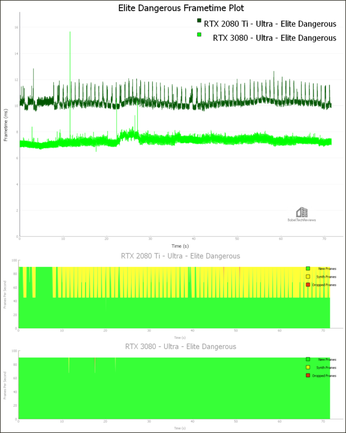

Elite Dangerous for example 2080ti vs 3080 is a 42% improvement
yellow is reprojection.
