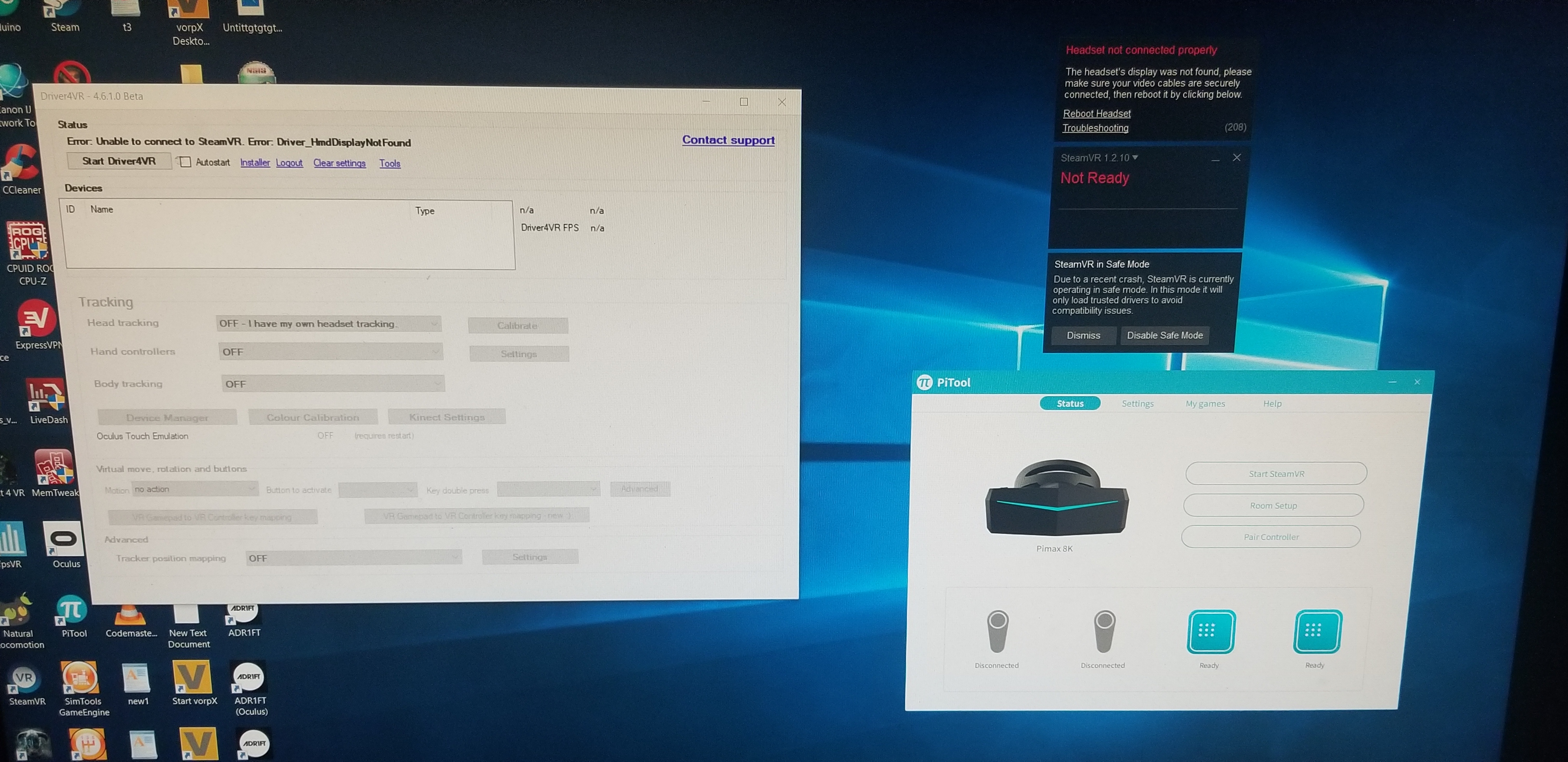

Is there any way to close completely everything related to the pimax headset. I have a feeling that there is some drivers of the pimax that are in my PC at boot and those drivers are related also to steamvr . If those drivers related to steamvr throught pimax are loaded in the background while I install driver4vr, the driver4vr does not install properly in steamvr.

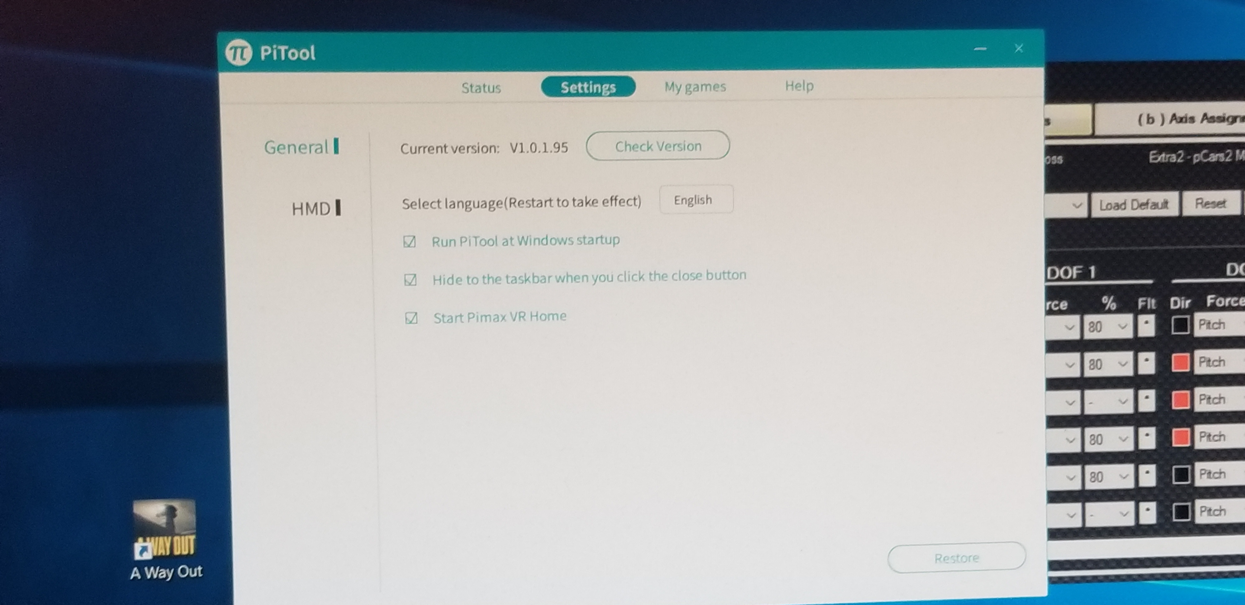

As for pitool. I have been running 103r191. If your running 95 might be best to stick with it during your testing.
Would you please be able to try also on your pc of you are not able to install/run driver4vr?

I downloaded the latest demo, however since I have used the demo before I’m getting “You’re trial period has expired”, so I can’t test with Pimax.
